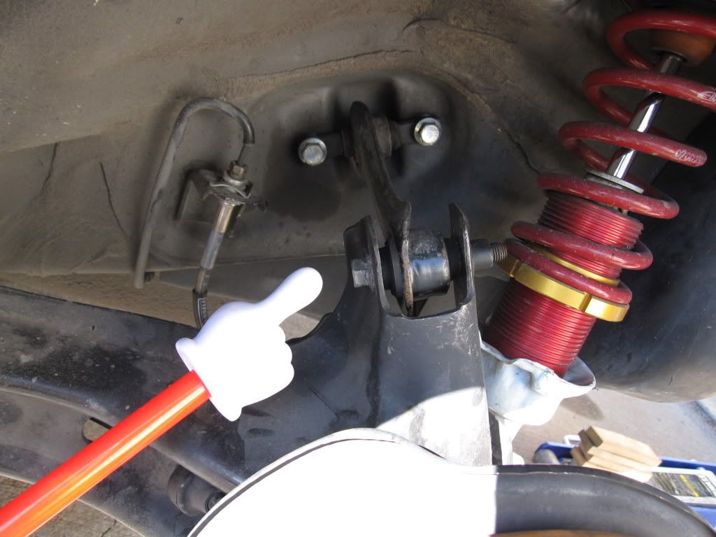

Note the resemblance between http://www.zerotohundred.com/newforums/picture.php?albumid=1430&pictureid=5841 and http://www.zerotohundred.com/newforums/picture.php?albumid=1430&pictureid=5843:biggrin:
This is where it normally is... http://www.zerotohundred.com/newforums/picture.php?albumid=1430&pictureid=5842
1) Mounted to the strut or lower arm, depending on the design of the car
2) Anti-Roll bar
3) mounted to anti roll bar
Other variations may include: http://www.zerotohundred.com/newforums/picture.php?albumid=1430&pictureid=5844
Cheers!
*errrr....i think this suited more to the dog-bone arm linkage..
