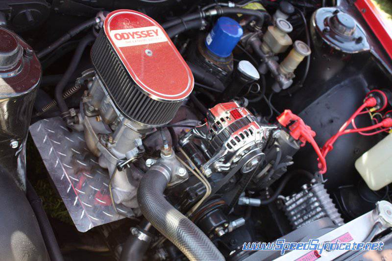

weber and 4 throttle

erm im not a pro, well im using a webber on 13b engine now, for tuning i guess in k.l gt pros near subang. But when u taking ur speed u can really feel it man and the roaring of the engine hehehe
rotary engine fren
small thing but not small output hehe
sky, nice pic hehe
