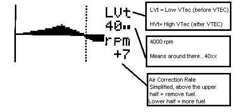

The map should look something like this (Without settings.. there should be just a flat line.. I took this out of a screenshot in google..)
Under [Setting] -> "Wide Thr."
Simply put.. since the VAFC uses air correction rates to increase / decrease fuelling, you should be able to see the effect on the A/F meter each time you tweak the air correction rates.
For purposes of explaining.. consider that each time I say add fuel, that means I added more air correction on the LOWER part of the graph.. when I say remove fuel.. I added more air correction on the UPPER part of the graph.
