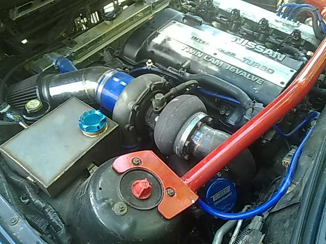

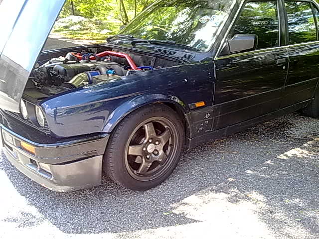

Stock OEM block from Halfcut to E30 Bmw old School.

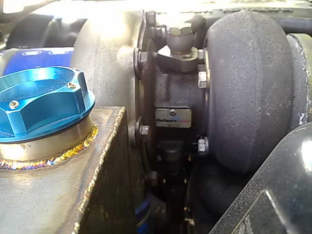

Bullesye Turbo sucking air to boosting 1.7bar.
455.8whp look at the dyno dynamic pump gas.
Max Rpm 8500 rev cut LT control
Thanks Speed Spin advice for turbo tech.

other specs...? injectors....cams....etc...mind sharing.....how hard it is to get the 450whp
Nothing special.Stock cams,Stock pistons and rod.Stock fuel rails.
Injectors 750cc,Performance Coils pen type and Walbro pump.Tune properly and u can get a better result.
