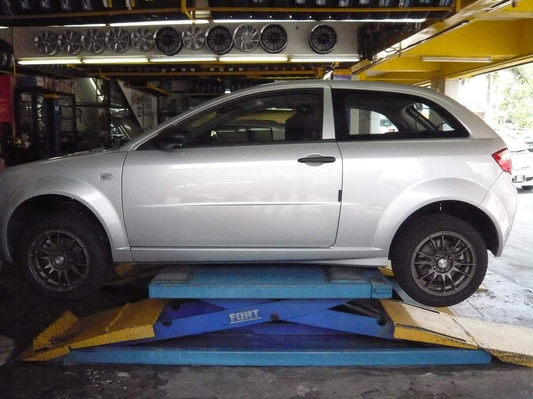

already changed my steel rims to 15" sport rims...my choice is kspeed with oz ultraleggera design.
while fixing the balancing and alignment

Not necessarily bro. You should take your car height as a factor too. Ride height too low & soft suspension would definitely rub your arches even with +42 offset. Before my current setup, i use a 6.5jj with +32 offset running on 195/55 series tires with lowering spring. The car sits nicely without having to roll my arches.
NO promises but i'll try to upload it soon :burnout:
i know bro..but now i use 7jj+40 offset..
if u use 6.5jj+195/55/15 that is no problem..
