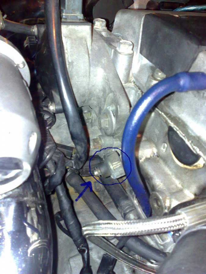

the oil press sensor mounted at side of the block under the CAS/distributor..
last time i also face same problem, suddenly alladin lamp lite-up, service with new engine oil also still tak padam, found that the sensor faulty.. change new, settle...
Is this the sensor? Memang the wire just putus recently...
Hope it is the cause.

bro just change it new. cost only 30 to 40 bucks....its similar to all mitsu proton models. cheers
but.. one of my friends also told that oil pump fault can cause the lamp to blink....
because low pressure and the sensor cant detect the oil pressure..
if u have oil press meter, u can monitor the pressure
