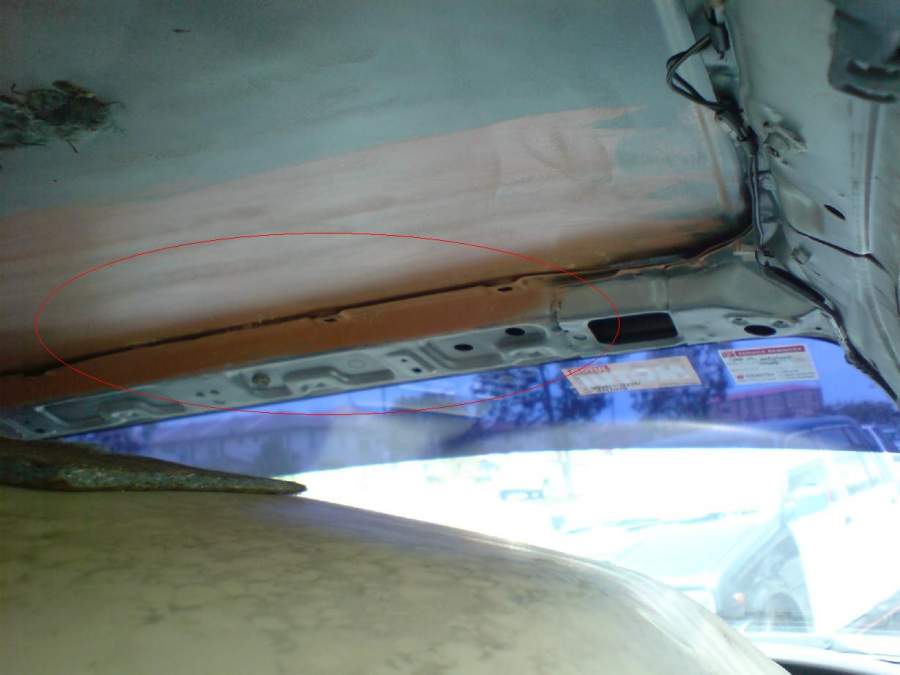

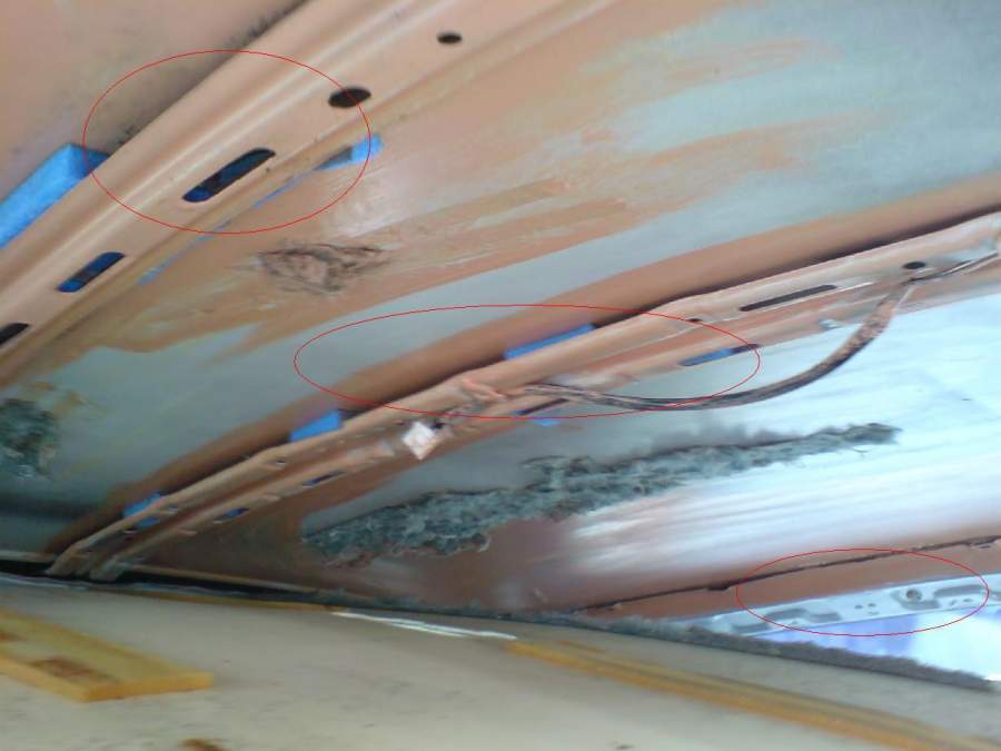

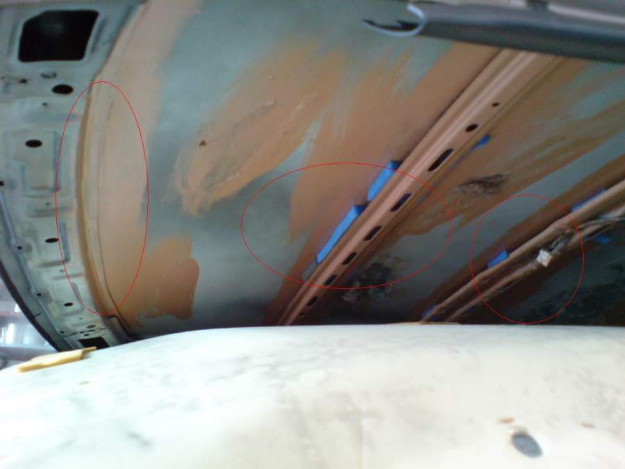

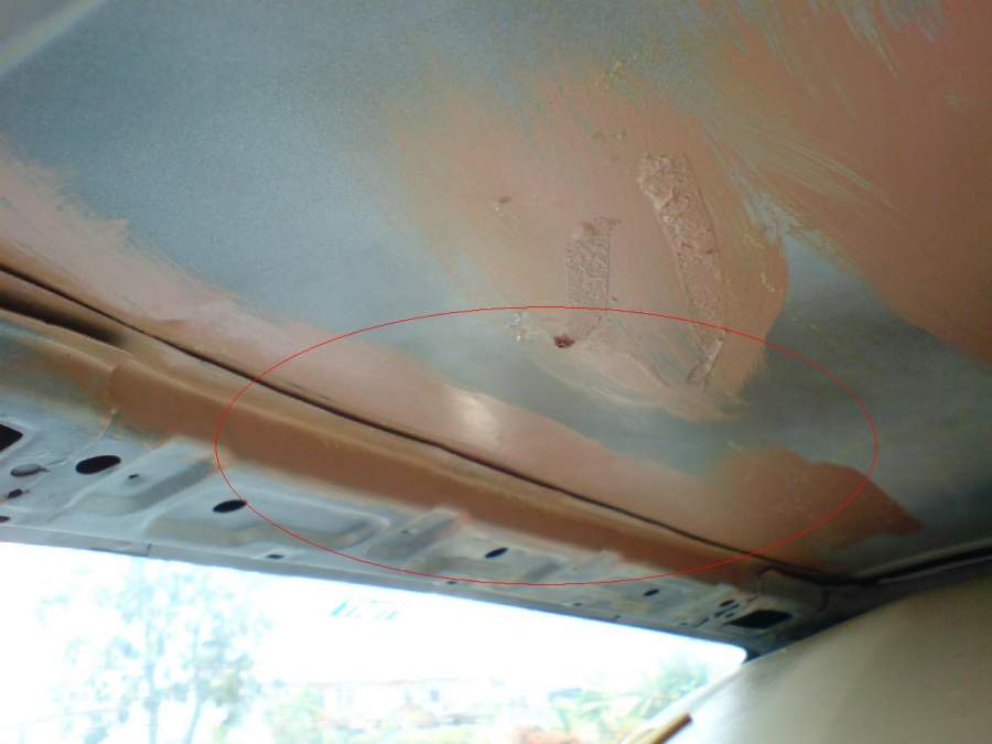

hey guys, hope this will gv you abit of info dealing with rusted roof.
1)[FONT=&quot] [/FONT]remove and clean up all the silicon glue or rusted area from the roof area.
2)[FONT=&quot] [/FONT]apply anti rust primer for top and bottom of the roof especially the rusted area. (try Hammerite Anti Rust Primer– you can get it from Home-Fix at 1 Utama Shopping Centre - RM60++ for 500ml)
3)[FONT=&quot] [/FONT]apply further 2 coats allowing 30 minutes after each coat.
4)[FONT=&quot] [/FONT]you have to wait for 4 hours for the topcoat.
:wavey:

For my case, I can finish it within a day bcoz the rusted area not much and not so serious. So if you have some scenarios like me then I bet you can complete in one day.
For better result, remember to apply the anti rust primer before the top coat.
Just to share…:smokin:
