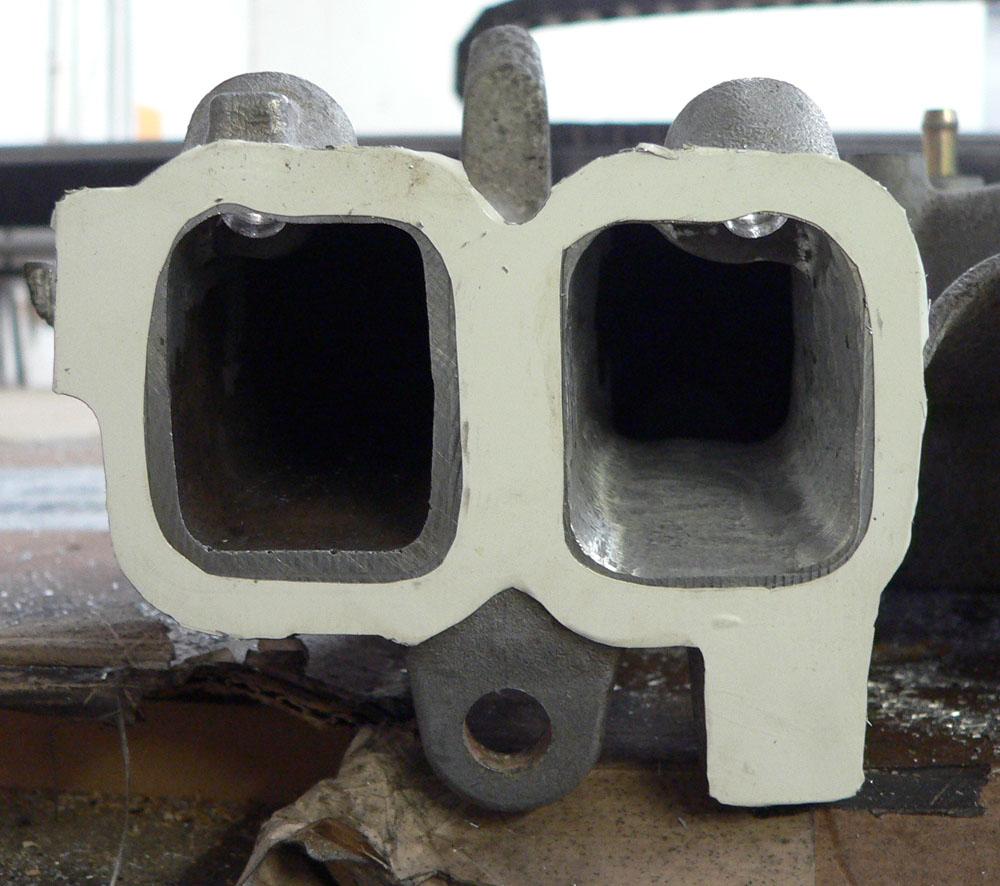

3) port polish means making the cylinder head intake and exhaust port bigger and smoother...
oem vs pnp head
