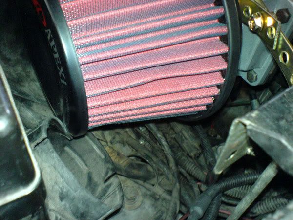

Anyway, anyone know why my mounting is so awkward? Aiyo, last time my KNN also spoilt because of this, now my Apex'i also? I have to push it upwards so that the black plastic is resting on the er... hose opening? Before this, the filter element was on the hose opening, and it bent the filter abit.
See how the plastic bit is bent.. is that the air intake?
