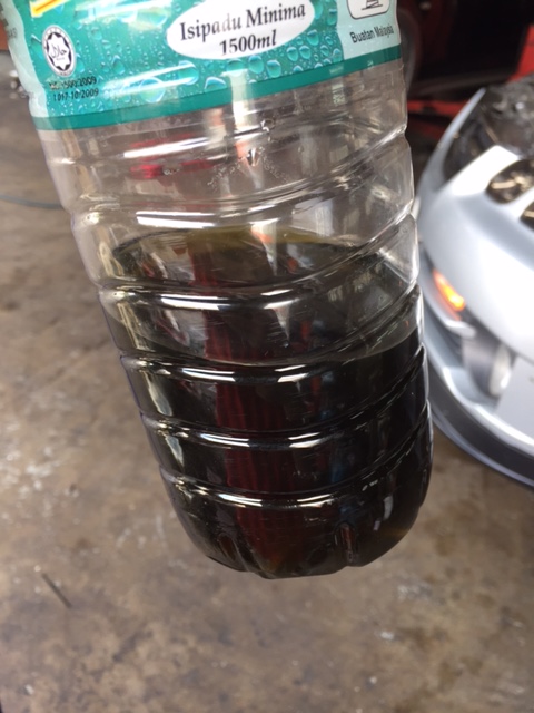

Below is the cheap mineral oil I use for flushing. I drained the old lube out and pour in fresh new lube. Let it run for 20 mins and here is the result. I got a shock how dirty it was. It looks like I've driven it for 3000km or so...

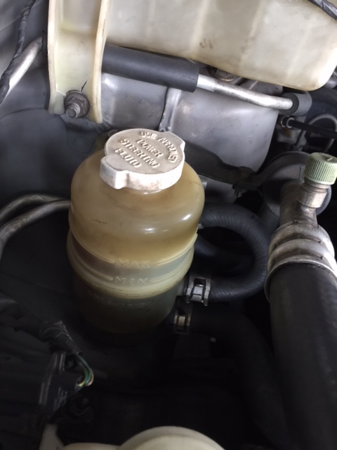

Power steering oil replaced too.

That's an impressive amount of dirt for a cheap mineral flush. What mineral oil did he use to get that kind of black oil result? It'd probably be even worse if you used a additive flush
I used Fuelguard Winston SAE40. I just asked for 'cheap lube' for flushing and they gave me this. It was only RM29. Since it was SAE40 (for trucks), it's quite thick. I plan to flush again on my next oil change and see if it's still so dirty.

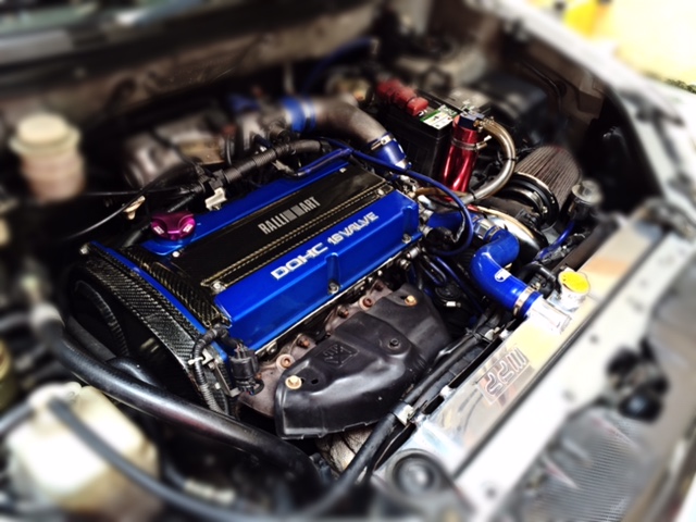

Anyway, your blue theme engine cover and etc looks nice!!
Thanks bro... well if my oil-catch tank is blue, it'll look even better. :) hehe...
Well, I used to go all blue when I had the Ralliart oil filler cap. Then I was so much into detailing and almost got the Tomei header cover but it was too expensive and not worth it. Anyway, I painted my drilled original manifold cover (for TD04) to fit my TD05 manifold with high temp black paint.
