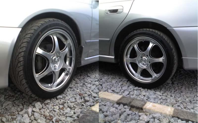

3)I just changed the sport rim and now the gap for rear wheel look not so nice if not get lowered my car.Is it just enough change the spring or get an adjustable one?Now I feel very comfortable with the standard one and I'm afraid if I change the spring, the feeling is gone.Can all V6 users that lowered already your car tell which one you choose for your car..change spring or change to adjustable?

Bro, Nice Rims. I’m driving a V6, 2002 model as well. Bought the car 2nd hand 2 years ago. When I bought the car I had an option to buy UniAsia insurance worth RM2,500. This package is to cover all known V6 problem’s from gear box to ECU till the power windows and aircond compressor. The package is valid for 3 years. Practically when your car has a problem you can drive in to the Proton center in Kepong and get your car fixed.

change the gearbox will cost you $$$. I had this problem before 2 times changing the gearbox. I got so frustrated then converted the engine with manual transmission. now no more headache bout the gearbox. the fuel more save then my previous SEI AT even its a TT engine...but with normal drive lah. Its depends on you now. If you want the performance n fuel saving, then go to MT..if not just stick to AT but try to install the ATF cooler, good maitainance & driving style also will affect the AT gearbox.
change the spring will make ur car look sporty & better handling. but changing the spring will oso makes u a bit uncomfortable or bumpy (depends how hard your suspension) and oso the parts will affected is your driveshaft & lower arm. If you want to look nice & not so bumpy, get the adjustable suspension but use a progressive spring...eg eibach pro kit spring. If u just change the sports spring, u cant get the nice gap between your tyre n the fender that u want.
