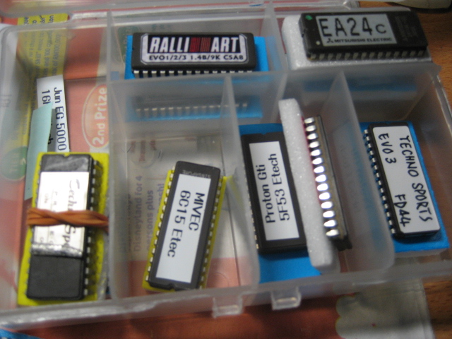

Hello Mr Sapeqlaa. I'm not mivec sifu but i think mivec 2nd profile is higher than 272 degree. So i think if u wanna plonk in high cam for mivec, the camshaft spec that available in the market now is only 30+ degree. correct me if im wrong.
Btw Mr E-Tech, ur chip is custom to engine spec? looks delicious.
Yes for certain engine set up BUT not Custom tuning...
e,g mivec chip- for those with 1.8 block and ETC...
