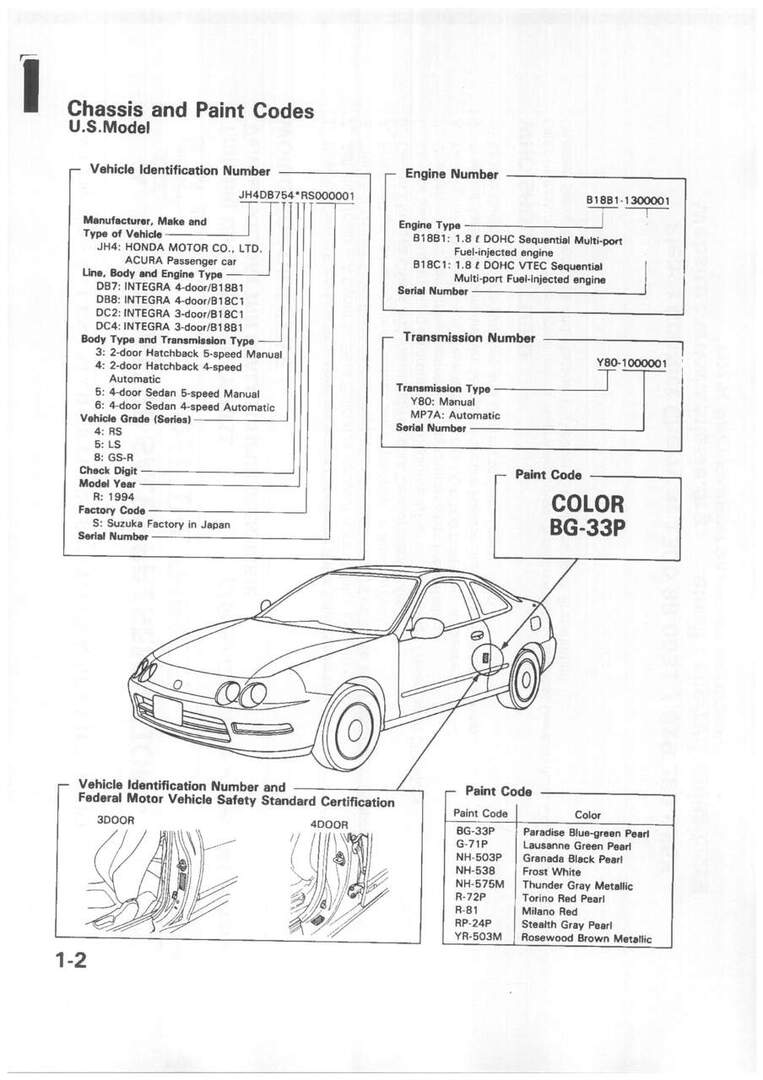

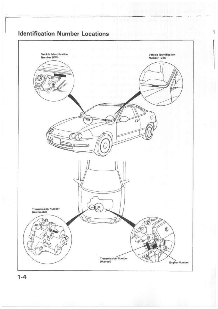

Hi.. Engine code and gearbox code locations as per the pics.. but this is US model.. think should be same or similar.. :hmmmm:

the location of the engine number is very easy.. stand in front of ur car.. open the hood... and look right to the LEFT of ur extractor.

Thanks bro. I also managed to get this owner's manual from the net. But i dont know which is the gearbox code. Btw, what integra are you using?
