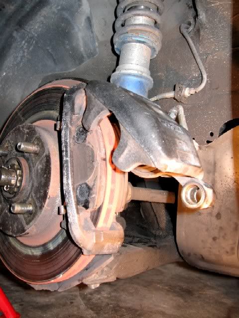

model 2008...hmmm...
2 years already...
in certain time...
you need to check your caliper...to make sure it's a good shape...
make sure the main caliper piston move without hesitation...
the pin lock not stuck...

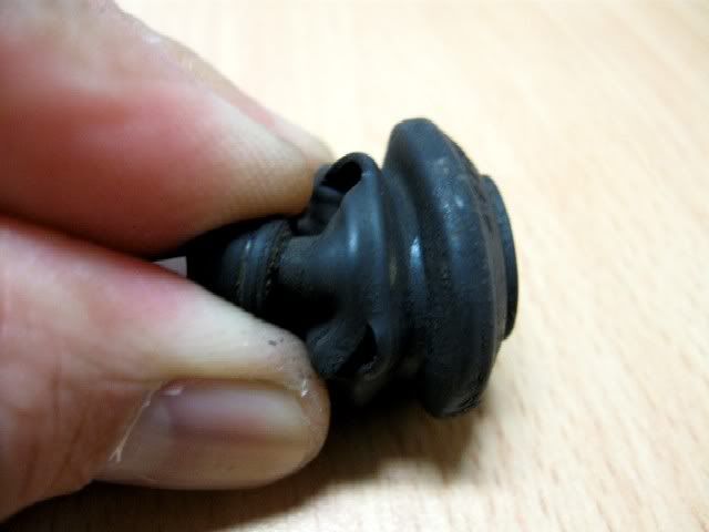

pin boot not torn out...
after service put some rubber grease to make it run smoother...
few guide picture...
