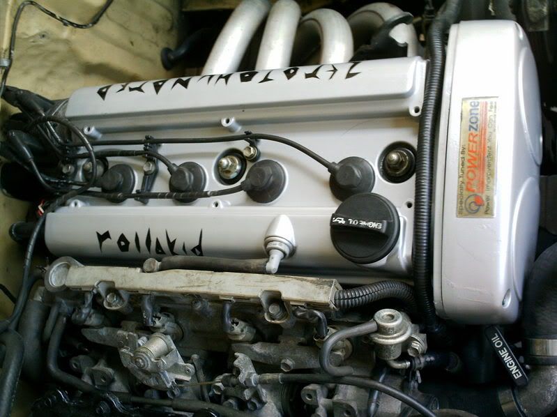

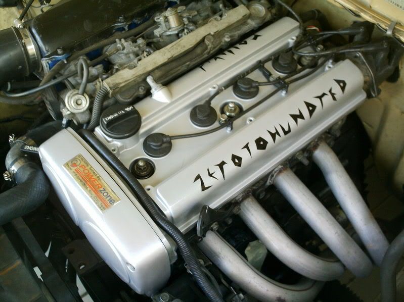

someone say my cam cover very dirty.. so i did something: =P
U sound like telling is me who saying ur engine dirty orrr......well, very nice design for the cam cover!!!!....ahahahah....
