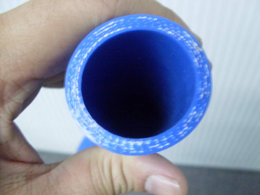

thanks works engineering for the radiator hose..
support made in malaysia products....
good quality, value for money :love:

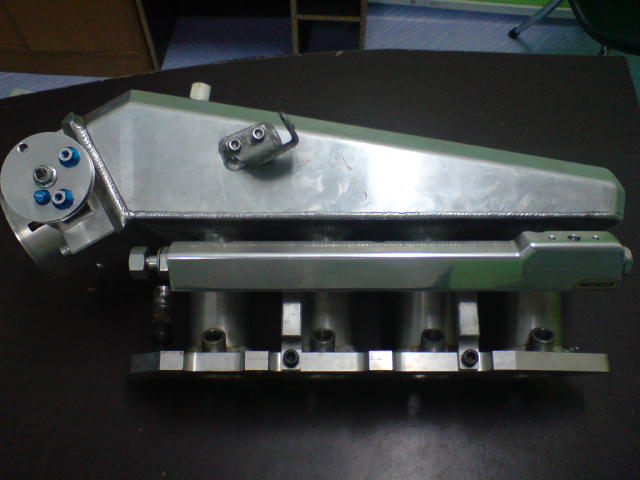

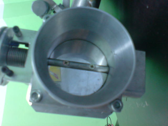

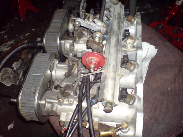

which one below is better???
super 90 + 75mm TB
or ITB??

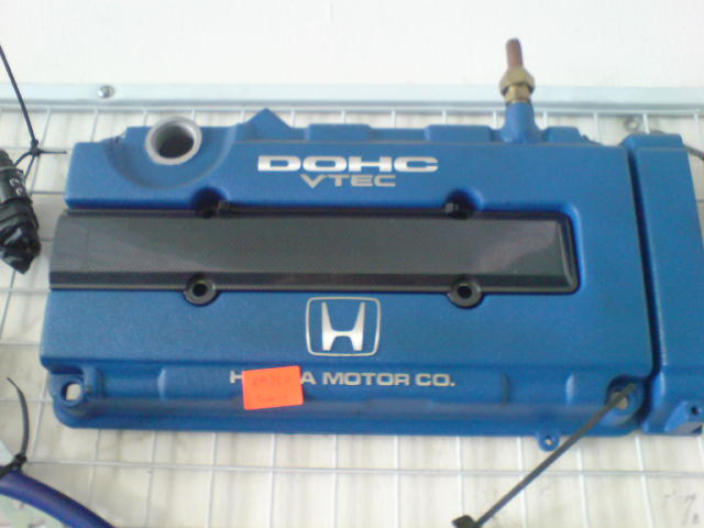

my newly done valve cover.
custome paint to perfection....

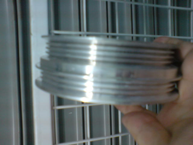

and my crank pulley from works engineering...
value for money,,..............

u should try both and tell us the results if time and money
is not a problem to do some personal r&d. it wouldnt be fun
and selfish to generalise a certain setup based on personal
opinion.
run with a standalone on both setups and see hows the results.
super 90 + 75mm TB
or ITB??
