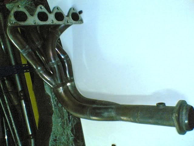

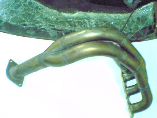

I'm looking at a slightly different tri-y. See the below:-
Big Tube Tri-y
http://i80.photobucket.com/albums/j178/thtan777/B-TriY.jpg
Custom for B20 race engine
http://i80.photobucket.com/albums/j178/thtan777/b20stainless.jpg
Custom for B18 race engine
http://i80.photobucket.com/albums/j178/thtan777/b18_1piece.jpg

Thats why i also don't know the reliability thats why don't want to try the single or two ring type. For your info, i also have seen a set of Mugen N1 race pistons which happen to be also single ring and damn light!
Big Tube Tri-y

Ah.. those pictures you posted are the two piece versions... looks like it's made for better ground clearance. I don't think I want to hear the price tag on those.. I can pretty much imagine it already.. haha..
Still, those headers in my pic are huge.. I think much larger than some of the more common ones. ground clearance is on par with a mugen B18C header, so it says a lot about the size of it.. :P

Yup, your pictures of 4-2-1 are huge. Was just trying to show you, i want to get something longer tube as well for broader torque :)
