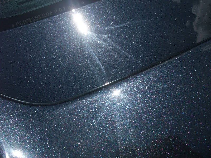

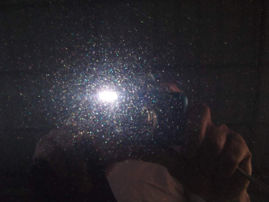

Thanks for your opinion, For your information i have been ask back to my friends, he is using polishing pads yellow color (no brand) and i see the polishing pad it quit rough, and speed of the rotary is 3 (1700rpm), and he also wax at speed 2(1300rpm.)
On saturday i use bosch random orbital, swirlx and nxt 2.0 the whole holograms disappeard, more shining and all the defect like swirl & water stain removed.

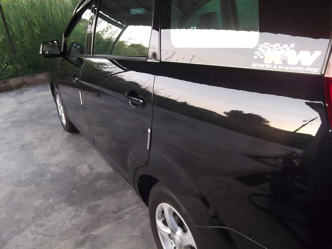

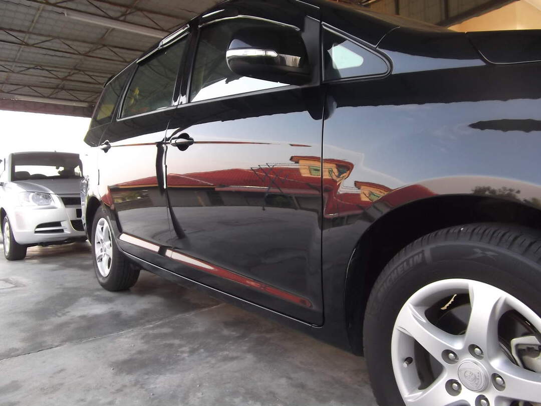

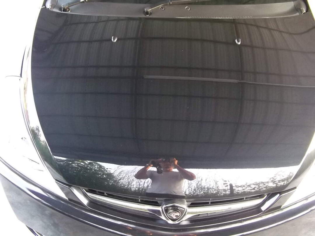

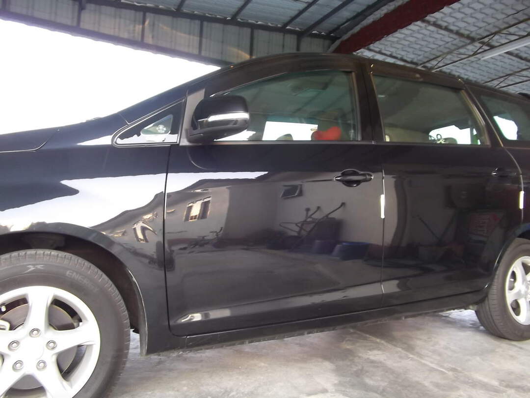

K thanks bro, i just use optimum hyper polish, and this is the result
