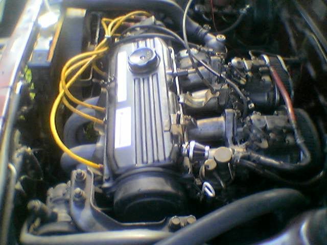

Originally posted by chooz@Dec 20 2004, 20:50
haha... 4G15 master khoyos
140bhp on saga! believe it!
hmmmm... maybe 1 of the 4g15 that DARE to mod the engine...kinda miss his engine which had been sold separately... if only had the money that time...sure grab his RPW 292 cam...haih....the pic : :unsure:
