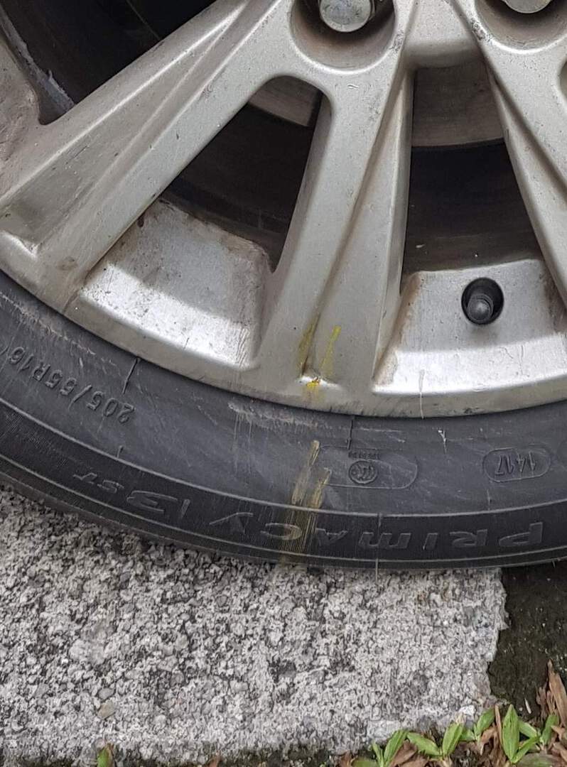

Not sure what you mean by remounting. They place the tyre & rim onto the machine. After measuring, they make separate marks on the rim and tyre. Then align those marks and do the balancing.

Yes, that's what I mean by making separate marks on the tyre & aligning them. After initial measurements by the machine, they mark those 2 separate spots; one on the the tyre & the other on the rim. Then deflate the tyre so that it may be manually turned till both marks are aligned.

If using a lot of weights, your tyre shop is just lazy to deflate and shift the tyres round the rims. With the force machine it calculates for you making it easier only, but at my tyre shop if weights a lot they shift the tyres 180 degree from the rims and re-balance again. They do this at no extra cost since it is still in the balancing cost......lol:biggrin:

When the weights are a lot more than 80gms, means the tyre and rim have combine weight on one side, they just mark the tyre where the valve is and rotate 180 degrees. So far it has worked bringing the weights down. If not mistaken only once I saw that fail, and tyre shop remove the tyres and change to another. They mention tyre fault and will send back to manufacturer for further checking......lol

For balancing just need to de-bead tyre from the rim edge then and shift the tyres around the rims before inflating back....:biggrin:
