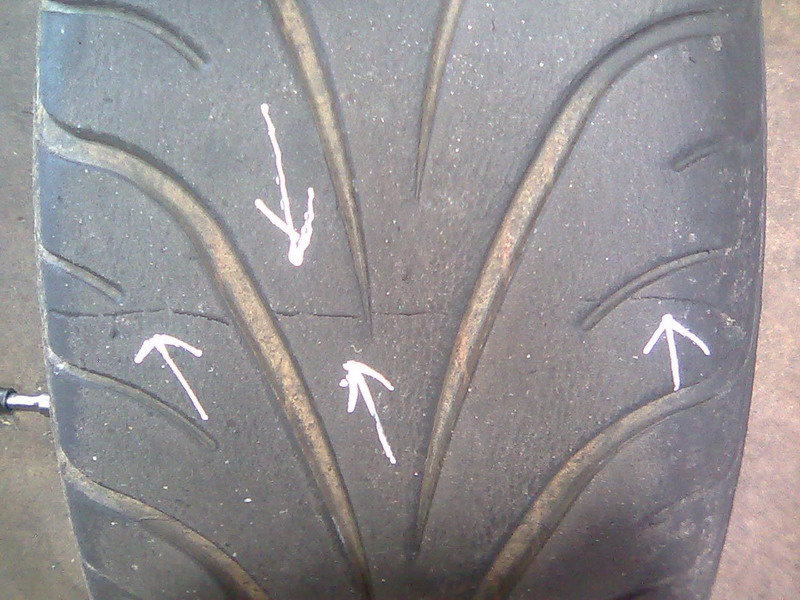

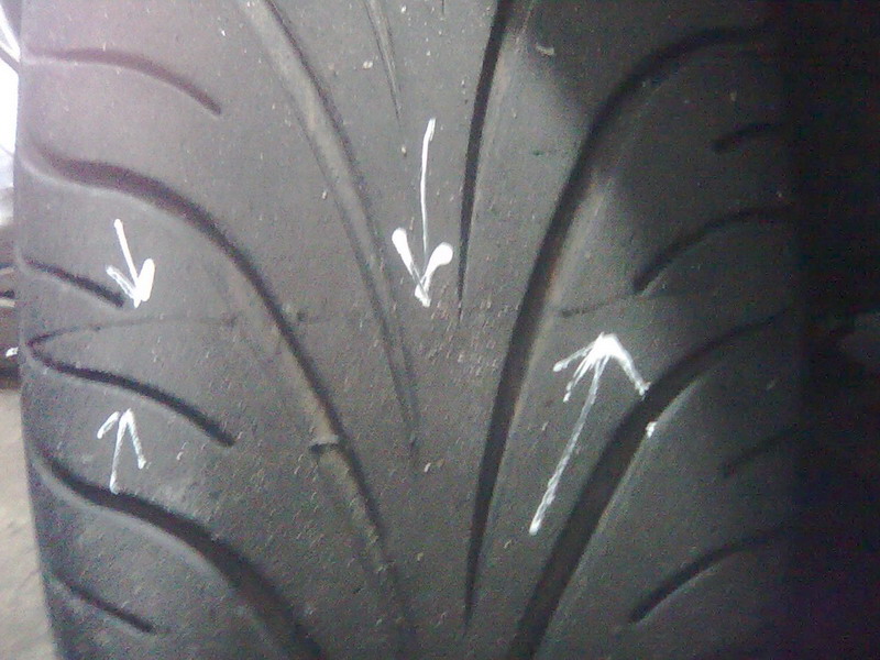

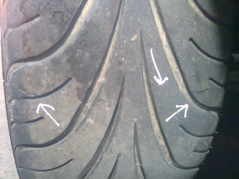

Just to share this is what happen to my 2nd set of Federal 595 RS-R. All 4 hv split this set I hv used it for 2 time open track day & 1 HPC time attack (wet). My is 18" ~4x09 made & I also notice others ~ 17" & 16" hv this splits but not bad as my.... may be only used on road not abuse on track days. So r this a comment Split if to trakc the tyres, but this didn't happen to my 1st of 595!! But if this tyres cannot run on track what used of it??
Also I'm not sure if the tyre importor hv let Federal Taiwan know about this issue. QC or Manufacture standard problem?
So for those hv this tyre now better go get it check to see if the split hv gone bad!

One of the tire shop has recommend me Kumho KU36 semi slick tires. They also complaint RSR has internal compound is too soft that's why split and also changing shape. They says first round RSR can perform well in track. But if you use it the next time in track the problem will come out already. This means RSR can only pakai satu kali in track only!
I may also look for the KU36. but I think the tyre shop didnt read it right leh.. KU36 is same like the 595 RSR just a street performance tyres. Not a Semi-slick yet... may be look like lah.
Normally a tyres hv a treadwear 100 or less can consider semi-slick group ie R888 is 100. RSR & KU36 r 140 & 180....
but My 1 set of RSR is ok... can Bantai ~ 5 track days before need to change & no rubber spilt. With this case I did saw other made hv this splits too ie Toyo R888, Silverstone FTZ RR & only RE001 in the web, but not as it happaned in so many tyres for the RSR.
