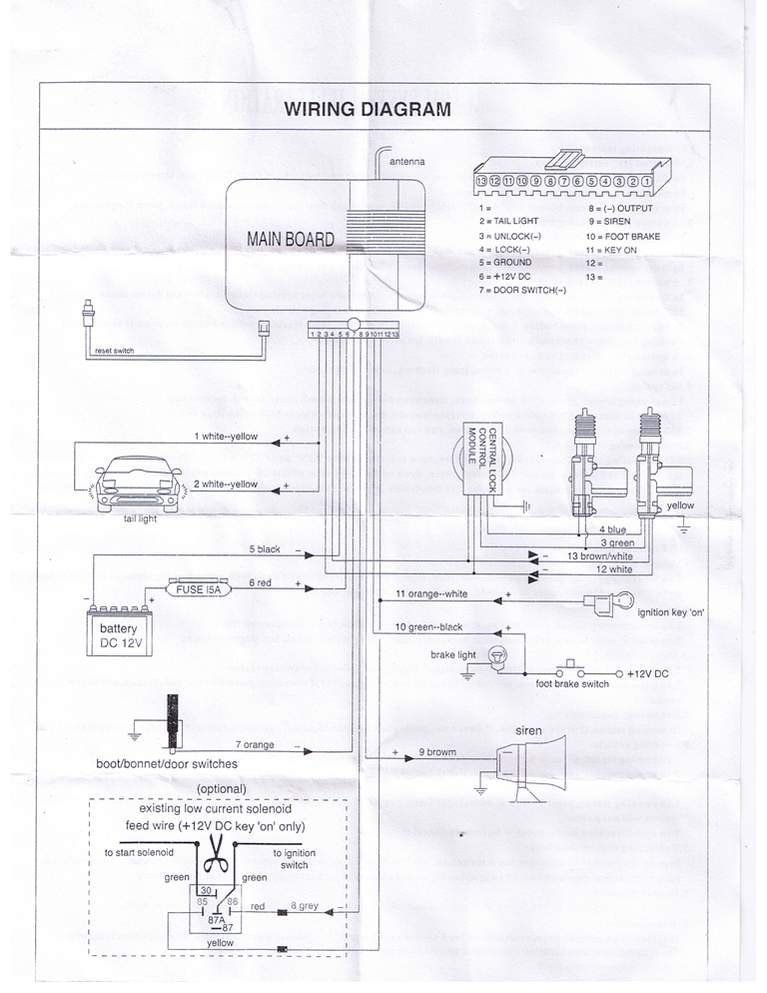

This is the alarm that I want to fix in.
Punch II Pro Serial Car Alarm System 4043M
Main Features:
1. Lock & Unlock
2. Door Open Signal Lamp
3. Reset Button
4. Auto Rearming
5. Leaning Code
6. Mute Arming
7. Impact Memory
8.Brake Lock
And I uploaded the wiring diagram de.

Hi bro,
Not familiar with Kancil, though this is what I can say :
1) It is easier to trace and reuse the old alarm's wiring. Check voltage & connectivity with multimeter.
2) Becareful of the wires colour coding. It may be wrong.
3) How come no shock or sonic sensor? You bought a <RM100 alarm issit ?
