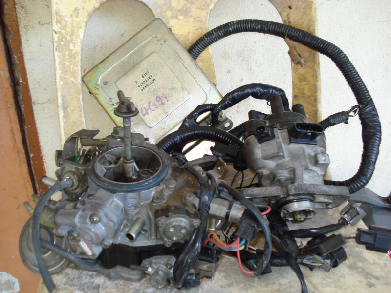

The 4G91 Carb actually is a feedback carb which is controlled by ECM and o2 sensor. So it's not easy to tune it properly without the ECM and sensor, the only thing can be done is using a rpm relay to trigger the secondary solenoid at certain rpm to provide more fuel in AFR. If tuned properly it's performance and fc is better than the ori proton carb.:stupid:
oh??? i thought that 4g91 carb is like normal carb system, i no saw b4 carb with ECU

4g91 does use ecu for it's carb:rofl:...for easy tuning for turbo carb i advise to use dcnf webber as it have many size of jet to suit the turbo setup...:biggrin:

Wiring for 4G91 carb:rofl:
