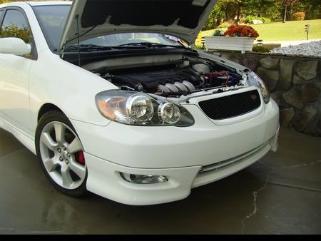

some pic & info...
simple mod done right.
... & wide body..
other images...

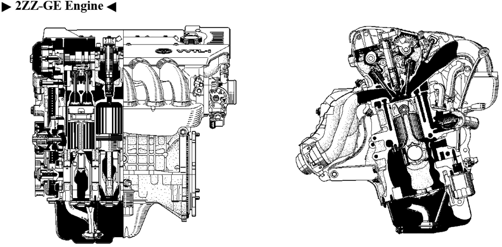

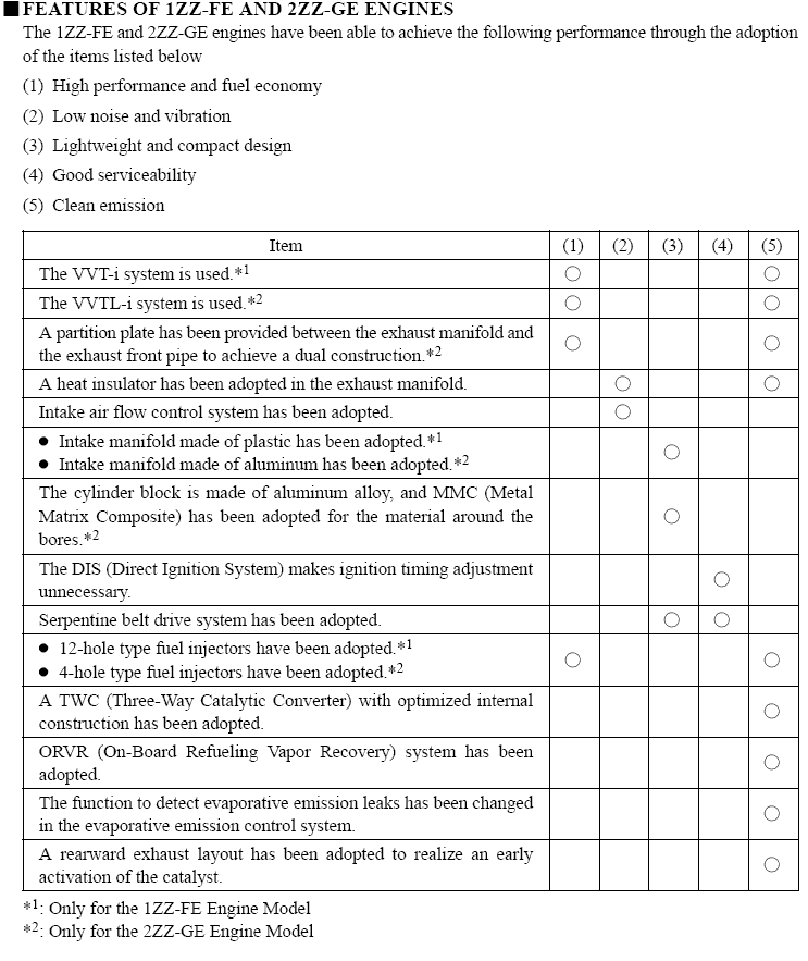

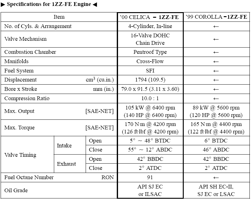

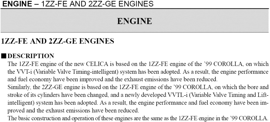

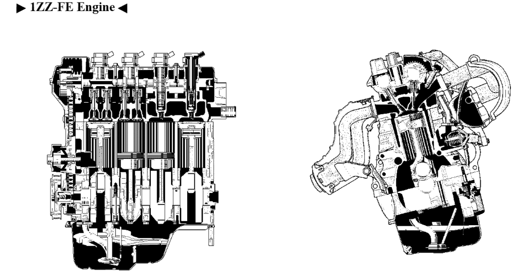

Comparison: 1ZZFE vs 2ZZGE
- 1ZZFE Spec -
can run on RON91 also ? hmmm.....
- 2ZZGE Spec -
http://i65.photobucket.com/albums/h220/wfhan/Altis/005.gif
this one must run on minimum RON95 lor.....
enjoy.

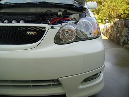

Bump: Wfhan..wide bodykit is nice but usually all fiberglass right bro? I prefer PU tougher material compare to fiberglass.
The TRD bodykit altis headlamp is nice. Never come across any before. What type of headlamp is that bro? So far, I only know of 1 which is Projector Headlamp for Altis. Damn...envy that altis have 2zz-ge Engine. No longer an altis but Corolla XSR.:driver:
for bigger dimension panel, fibreglass or CF is prefer as the weight is ligther compared to PU made of equivalent item. PU if the material (mixture) not done properly, the widebody will go out of shape due to gravity and its weight & temperature (of parking under hot sun of tropical weather).
* saw some PU bumper of other cars, which went out of shape when park long under the sun,
heard owner complained about that. *
that headlamp ? donno man, never see b4 the real item. no doubt is nice looking.
