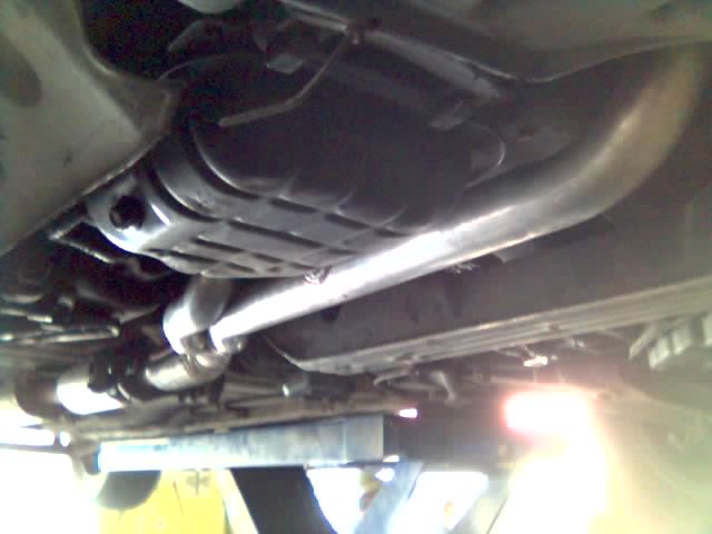

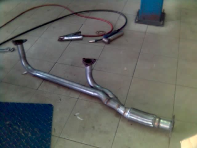

I've changed the downpipe about 1 year ago. Increased performance? Yes!!. Stop knocking sound?? Duh?. Nothing to do with that. But you would hear a v6 rumble sound when the RPM is between 1 - 2.5K. Maybe the rumbling sound would drown ur knocking sound, heheh..
Here's a pic of it.
