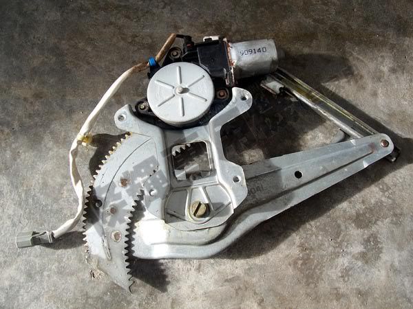

hi Sifus,
My franz just bought an EK, he claims that the car window is not an auto but manual mechanism, for those Honda sifus out there? how come EK will comes in manual window? i tot all EK suppose to come with power window, his car is EK3 by looking at the chassis. Izzit possible to convert the manual to auto? what thing should he looking for? wiring? switch? window panel? is there anyone there knows roughly how much should he going to spend for this including labour? thanks

sorry, i am not with my franz now, what could be the possible cost to get everything done for the damn power windows, not really searching for those ViRS door panel ,just normal local EJ will do?

You will need the motor, relays, wiring harness, power window switch and the power window regulator.
You won't need to swap door panel, just cover up the hole with some grommet.

Xtreme77, I still got the front passenger side power window motor with regulator if you want, also got a set of power window switch mechanism if you would like to have.
