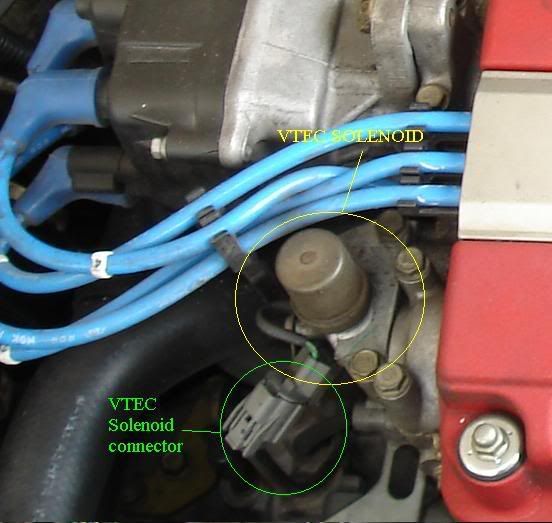

Check the ECU first for any error code, that's crucial to most of engine faulty. Get an ECU error code list and check the faulty part indicated by the ECU blink. Vtec solenoid is located near the distributor. Refer to the picture. In some cases if you keep revving without the VTEC engaging due to loosened connection might cause voltage fluctuation resulting more damage in parts like sensors. Just MHO.
Good work posting this with pictures..Hopefully there's be more guys like you and me who are shutterbugs with car parts. hehe.. go NGK power cables.. :P
ARTA
Dec 11, 2003
283
3,016
Malaysia
Visit site
helping others can reduce sin :) also good according to kharma . I've experience series of damages before, when my connector loosen. So that's the least i can do, try to help out :)
