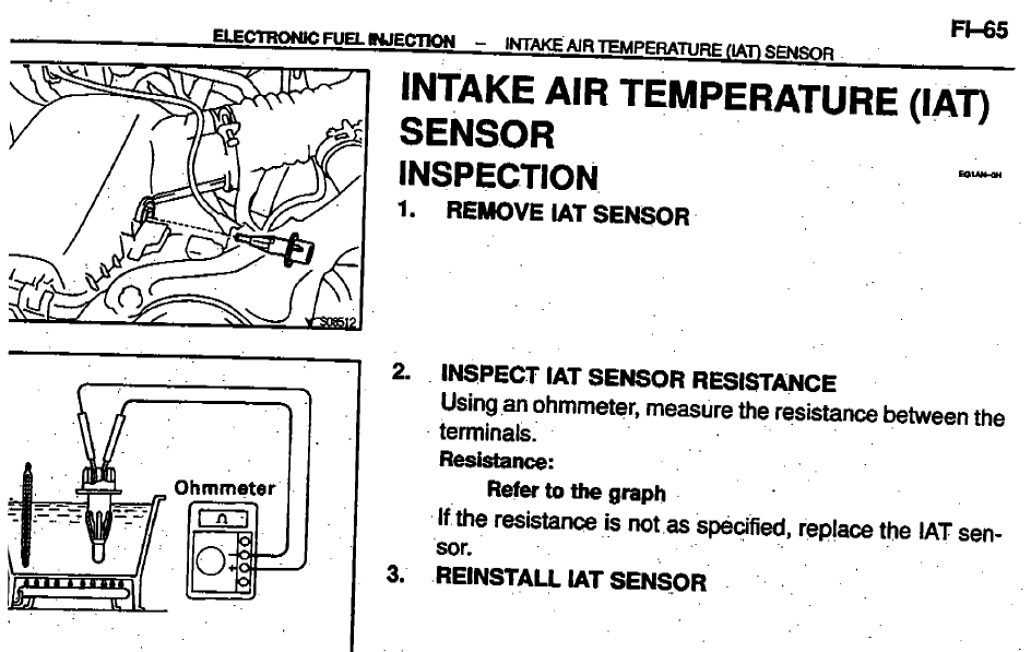

Please make sure that your Intake Air Temperature sensor is connected. Some mechanic who did this way of conversion will not bother to connect this tiny sensor because it won't cause the check engine light to pop up.
But with the absent of IAT, the engine lost 5hp.

hye there bro, regarding the IAT, wer is it located?? My meter also doesn't show the engine check simbol when my car is on..is that the problem of the IAT??
