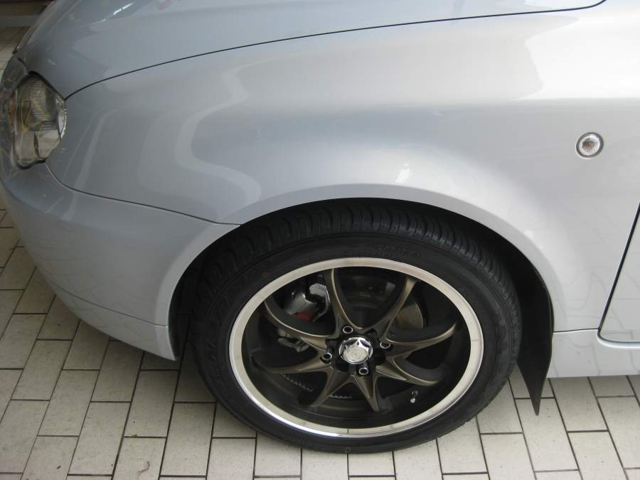

anybody here has solution about rim sangkut?
recently i had fitted 17" rim (CE28) with 215/45R17 but sad to say dat both the rear tyres sangkut when either more than 2person loaded in car or lalu bump w/o slow down (front tyre is ok, no sangkut).
beside replacing absorber or soil spring, is there any other solution?

take taiwan new rim or japanese used rim with 205/45R17.

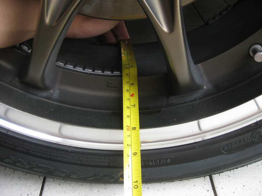

i got 17" japan rims, brand speedstar and width of the rims is 7 and half inch...izzit ok?

one more thing, my rims width is 7 and half inch, gen2 guys said 215 will sangkut on the inside so is that mean if the rims half a inch wider the rims itself will sangkut too:banghead:...what do u think kaycee?

im not sure about dat! gonna try then only know. but 215/45R17 tyre itsef would touch da rear mudguard.

The rim offset is wrong causing the wheels to rub against the balck fender plastic..if possible use 205/45/17 tires or 215/40/17...max width is 7.5 for our Gen2 rims...use R3 springs for money well spent:smokin:
