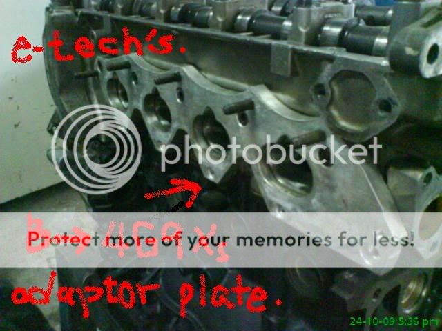

i head b16a intake manifold could be kacuk into wira 1.6?
could it be done?
Yes it can be done.....
2 options...
1. Cut and weld
2. make adaptor plate... later i attach picture...
Below was done so that the satria could borrow my DIY B series 4 throttle without
destroying it....
This is also commonn since honda big throttle easy to buy e.g super 90 & etc....
Here you can c....
Tq
