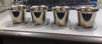

Plan to install trumpet for my BT engine but will install back with the plenum as well. Is there any difference compare to standard?
Any difference in sound even I install the trumpet with plenum as well? And better response & power?

i did that b4 with my BT 20v, well.....there is difference......
1. You wont gain alot of HP(without tuning)
2. Engine is a bit raw(noisy) like tsuchiya's AE....
3. Ur rev will be able rev up fast fast especially 4-7K rpm
4. Ur low end torque will suffered.....
5. Best to combined with it open pod filter like K&N
I guess it is quite close to open trumpet, yet more user friendly for the street. No harm to giv it a try. I had my fair shares of experience with this mod, yet i still find keeping it stock will be more suitable for my driving style.

You won't gain much of it.... waste money project only...
Unless you got higher piston compression and high cam... then only you can feel it help... or else with using stock engine, it was waste... FC also will turn high, car will cloak, engine very noisy, some more engine bay also will dirty, and even at raining day also engine running not smooth.
stock BT engine + ARC intake box + Tom carbon fiber induction box + Open pod = will get better result than you install the Trumpet

With the trumpet the rpm clim after 5k shoot very fast to rev limit loo.........the sound Vrooogggoooorrr Vtec killer sound......wah damn syok looo heheh.....

just install, what i feel pick up much better but top is drop from before. fc same like before. just not doing any tuning. plug and play oni

ya sound difference.... i'm using short red trumpet in side BT plenum, driver side trumpet have to cut a bit to fit in the plenum. more roaring power... :biggrin:
