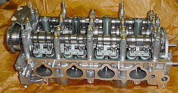

i got the info from here. Honda K engine - Wikipedia, the free encyclopedia@@AMEPARAM@@/wiki/File:K20_head.jpg" class="image"><img alt="" src="http://upload.wikimedia.org/wikipedia/commons/thumb/7/74/K20_head.jpg/350px-K20_head.jpg"@@AMEPARAM@@commons/thumb/7/74/K20_head.jpg/350px-K20_head.jpg
type s is running on engine with 160ps / 191 nm with vtec engagement at 2200rpm.
dun flame me la. me like integra ma. if every1 only like type R then no reason for honda to come out with type S lo. :) the japan type S is not the same as RSX type S, which got 200PS. tat's y i wanna know wat it takes to upgrade to that 200ps level.

by the way... to answer your question maverick... the 2200rpm engagement is NOT Vtec. its actually when the K20A3 engine switches from running on 12valves to 16valves.
Below 2200 rpm, only 1 of the 2 intake valves are opened. this is to save fuel.
K20A3 engine does NOT have actual Vtec.
There is no "wild cams" switchover point.
The Type-S (JDM) is meant to be a fuel efficient base model, not a modded race car.
Thats why we're all telling you to go with the Type-R and stop wasting your time on the Type-S if its power you want.
