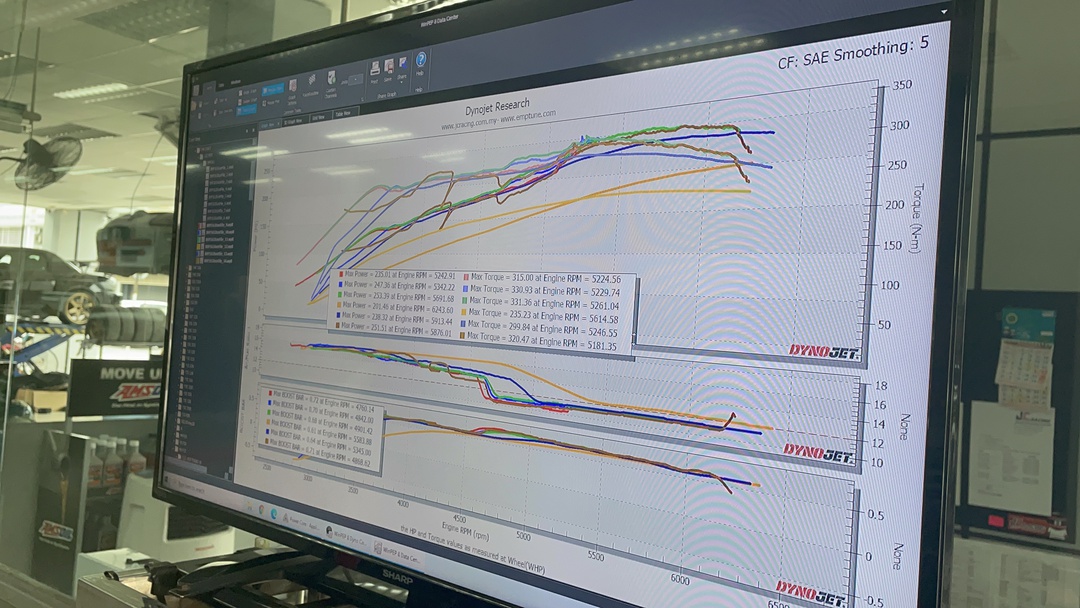

Hi Folks,
After 2 years of running my E46ci with unoptimized 1JZGTE VVTI, i picked up an Edamage Blue which i had for several years to hook it up. As expected, used ECU always had problems, my ignition harness is not readable but the rest of it works fine. Initial runs started with 235 whp/ 315nm wtq at 5.2k RPM. A few more runs and we achieved 251 whp / 320 nm wtq at 5.1k RPM. I am not sure whether this is a healthy result of 1JZGTE VVTI, considering factory declared crank HP is at 276hp which i knew its underrated. Everything is stock except for intercooler pipes, air filter pipe, downpipe and exhaust.
It does drive much better and responsive than before, turbo spool much better and does not consume so much fuel i think. Still experimenting.
Next i will need to fix up the ignition timing on the ECU, get aftermarket FPR, boost controller, and increase the turbo to 1 bar. We should be seeing at 270 whp after that.
Cheers,
Ken

All the above got me to 251 whp at 5.2k RPM. I think would be seeing 260 at 6.5k RPM as that's RPM cut off point.
I am pretty satisfy with what i have now but as mentioned, going to repair the ignition harness part, get a boost controller, FPR and i will tune on dyno again for 1 bar of boost on stock CT15B.
Cheers
Ken

250whp equates to about 310-320hp @ crank so that's a good number, especially at only 0.7 bar and you don't have much other mods. Btw 2jz in the US was factory rated at 320hp so 1jz by right should be lower.
Yeah with the traditional 4 speed auto gearbox, transmission lost at about 20%, i think its quite healthy, if i could adjust the ignition timing and increase the boost pressure to 1 bar, i should be seeing 270whp, but for now its fun enough to shred some tires. Next plan is to modify the mechatronic to make the hydraulic oil pressure higher for faster shift.

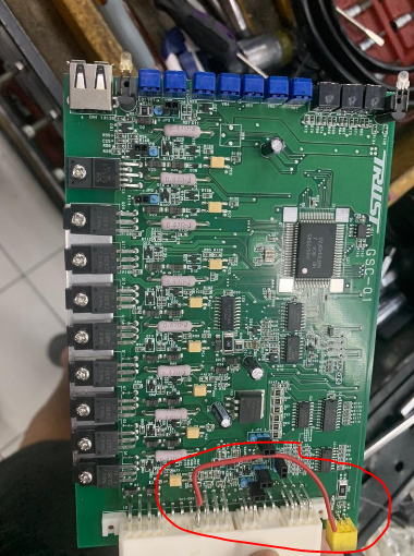

Definitely damaging but less damaged taken. I can still spend some for other mods. But first want to fix this Edamage (literally). Can anyone see if the below can be fixed ? I need my ignition timing back, JC Racing's Jacky said the circle area is the damaged or faulty area.
i recommend Repair ECU 1 Malaysia - Steven is pretty damn knowledgeable. But he's in Pahang now, no longer in Subang.
But hor... the reason why I call it eDamage is because of the number of fakes out there and the way the eManage mysteriously resets itself in some cases plus how it's not able to manage close loop, you're better off with a better ECU. What you using now that the eManage is out?
Save up for a proper Link or ECUMaster or MaxxEcu standalone la. The difference is night and day and the amount of money you pay to have it tuned is just a little more vs the Greddy.
