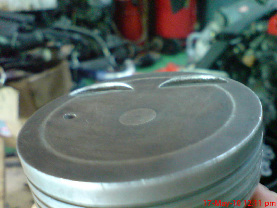

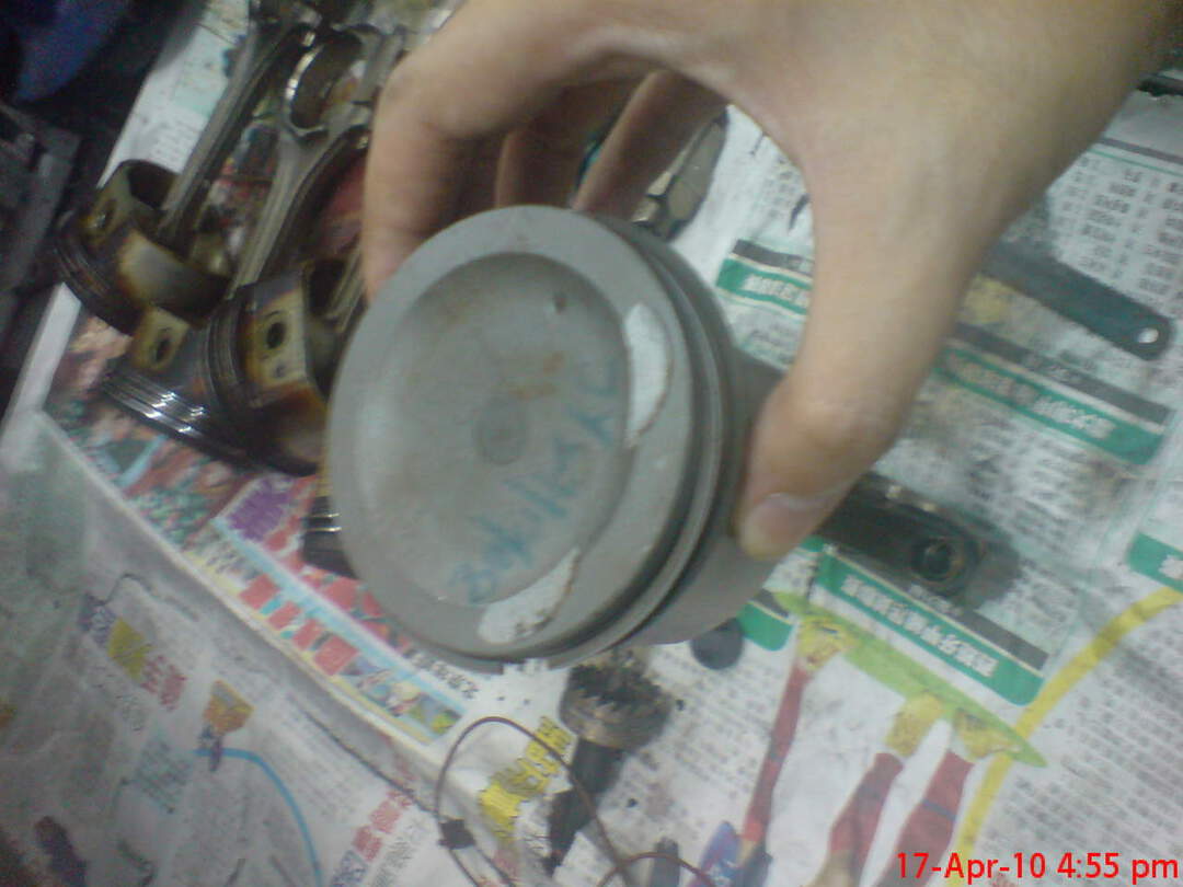

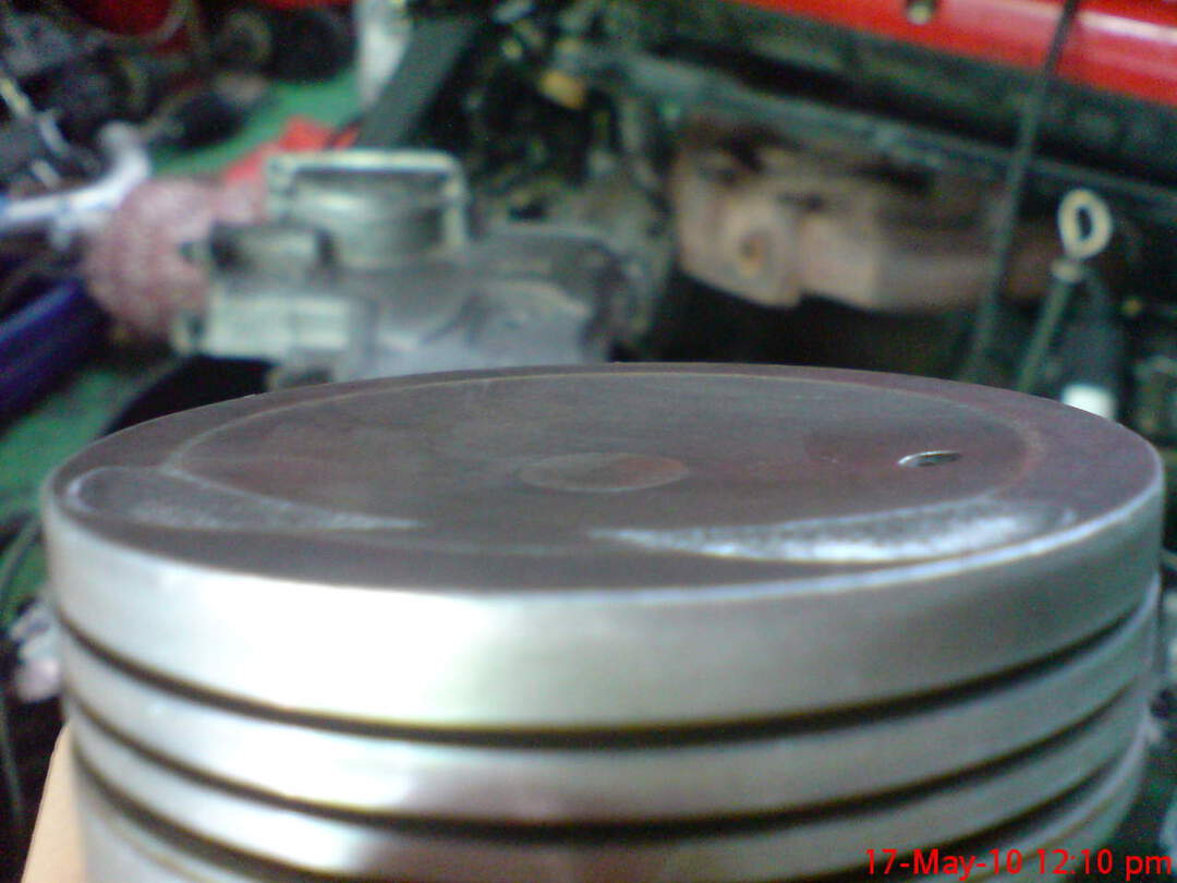

Good to share with you guys since i'm the k3ve2 owner. Attached is the piston between normal k3-ve and k3ve2. Actually i was trying to bore the piston and find aftermarket piston. However i abolished the project
