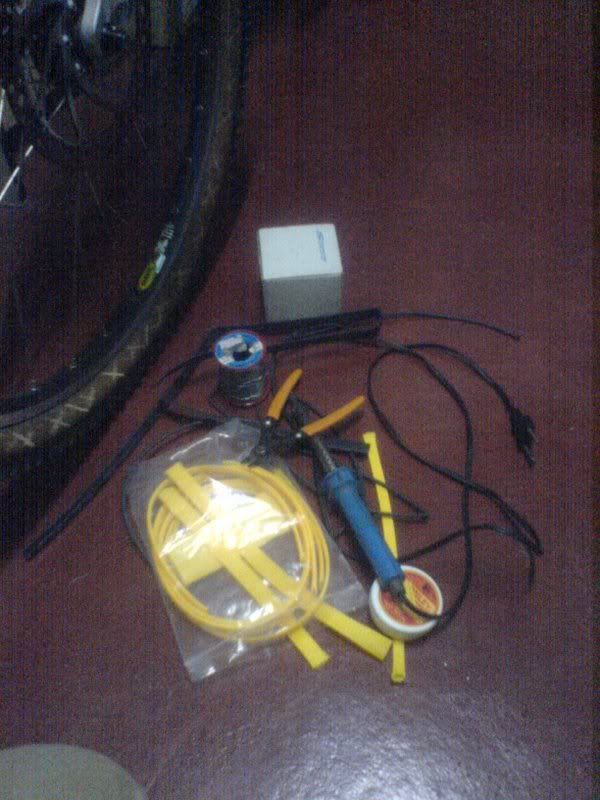

Actually I have the stuff like wire looms and stuff.. but chickened out on doing it.. I'll try post some pics, but take time oh!!
And the wire loom in the picture was bought from a computer store.. I've since learnt that there is another version sold at jalan pasar for heavy duty equipment, and they're thicker and only available in black. It's the same one that appears in the magazine article I've told you about above.

The wiring kit I always have around when I was doing rewiring for the rear bonnet area (previous owner modded the car as an audio show car, evident by the cut wires, holes and etc. UGH!) The looms are just leftovers from my computer PSU wire looming thing done maybe two years back.
