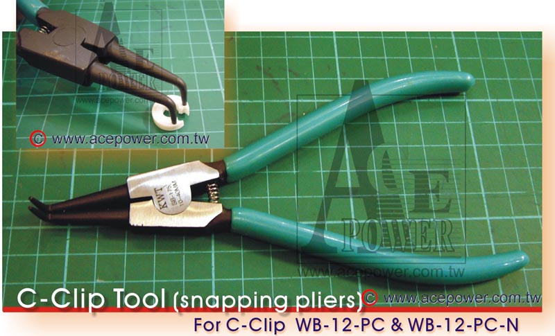

The special 'tool' I've learnt to turn the caliper is the long nose plier :biggrin:
same here :biggrin:
but not i found out a better "special tool"
using the multiple clip plier like this
http://www.hobbyking.com/hobbyking/store/catalog/cclipplier.jpg
pomen : wouldn't that tool be really soft? The long nose plier is very solid ler. This c-clip plier isn't going to be strong enough to turn that piston
