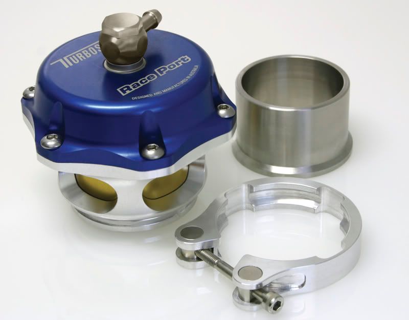

try Turbosmart Raceport.. built for race purpose and will take any amount of boost :smokin:

well..turbosmart raceport has a "street" setting spring set for road cars with alot of vacuum. So yea..it'll work on street and MAF cars too.
i guess , turbosmart mechanism is similar to tial's
requires spring change if setup has changed and vacuum differs

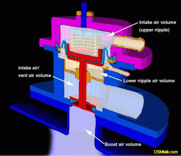

there are a few reasons why i would use a synapse, ok let me write my karangan kakakakka
first , it has something similar to the HKS type-II & ssqv , the more boost, the more secured the BOV will be , because boost pressure will pressurize inside the bov which will press the valve against the bov, diffrence between HKS and the Synapse ? , HKS uses a diaphragm , while synapses uses o-rings
another diffrence between a HKS and a Synapse
both are pull type BOV , HKS uses only one single nipple or vacuum source to pull open the valve when u want to open up. While Synapse was designed a diffrent way , it uses two vacuum source to pull the piston and one boost source to help push it , so all together 3 nipples , this wht makes the BOV very very responsive , that is why it opens up at low boost and also high boost , and it closes shut to no leak when boost rises.
http://www.rhdjapan.com/images/product/51919/Image/Normal/Image.jpg
the left side is somehow wht the HKS looks like but lesser one nipple , as you can see there is a spring that pushes the valve down , and a vacuum source on top to suck up the air and open the valve when u let go your throthle
wht the synapse has done is that it has 3 nipples , see right side pic, when boost hits in , it doesnt let the piston move up or down , because both side are pressurised , it has two niples pushing the bov down and only one nipple pushing the bov up , and there is a spring pushing the valve down , making it not to leak. When you lift your throthle , the top right nipple will get vacuum source , the left middle one will also get vacuum source , the bottom nipple will get boost source from intercooler piping, causing the bov to open up freely :)
ready to see greddy design ?
the greddy bov's have a diaphram , it uses a spring to push the valve down and also a vacuum source that will push the valve down on boost and also pull the valve up when u let go your throthle , wht is the downfall of this design is that , boost pressure builds below the valve
unlike the HKS & Synapse , they build boost inside the bov , greddy pushes the valve from down , so if you run high boost and the spring cant support, the BOV will leak. What happens if you tighten the BOV nut above ? yes now it will stand high boost , but it will have a diffrent problem , it will surge like a horse at low boost because its too stiff for low boost
but ahaks , there is an alternative way for the greddy bov , you may tune or help the bov to open up at low boost , that is by fitting a BOOST source from intercooler piping to the down nipple of the greddy BOV. But then again, the BOV easily leaks when u run high boost cos the down nipples makes the valve to open up more easily. The down nipple is recommended more to cars that run very low boost and is unable to open the bov even after loosening the spring tension.
conclusion : why i chose synapse, no worries about diapfram , Greddy Mutiara motorsports does not sell diapfram for the type-s or type-r , u can buy online but it cost bout RM300 just for the diapfram , im not sure bout HKS's , i have a few frens running the greddy, all have torn their diapframs, nothing can be done unless u buy one new diapfram or close one eye , why i dint like the HKS Type-II , its because its too stiff for daily drive application, its sure to surge at low boost , but withstand high boost . Why i dint like the Tial or Turbosmart ? cos if your setup has changed , cams changed, vacuum readings start to differ , you need a spring change inside , i havent got a change to open up a Tial or Turbosmart, thus i guess SDF should give better reviews on them ,
