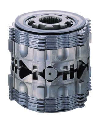

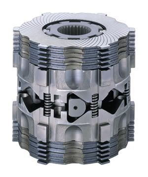

Yup.. but Cusco has two models.. RS or MZ...
only the MZ can set 1, 1.5, 2 way, if I'm not wrong.. could be both..
The RS is preset from factory, I think.. although as you can see from the cam design, their kind of the same.
The picture of the clutchpacks, so you can sendiri identify.
RS on the left, MZ on the right

i think mine most probably RS type... coz the plate can be clearly seen and the spring at the middle oso can be seen..
RS=race spec lar..lagi tak mau ngaku ur car is already supersixteen spec...hiihhiihihhhi
