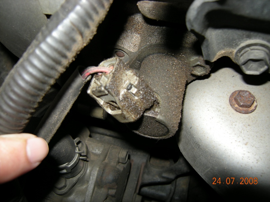

Bros! need help urgent! my VVT solenoid seems to be leaking but VVT still working. it leaks from below the solenoid. anyone knows/sells the oil ring and its gasket(if any)?
:itsme::itsme: anyone can help me out here?
VVT LED are working fine, but solenoid leaking...
anyone having this experiance?
i got my OCV replacement ...not more then RM80 (labour charge included)...that was 2 years ago...
