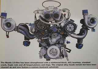

bro..im a fan of mazda v6..i believe v6 can beat alot of cars outside. this really depend on how much u are willing to spend. v6 can actually go up to 800+ if modded crazily..

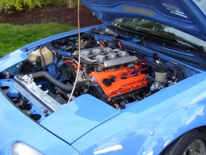

pls check out this website:
offroadvw.net - Baja Wes - KLZE Cars
anyway im just sharing my thoughts..hehe..
