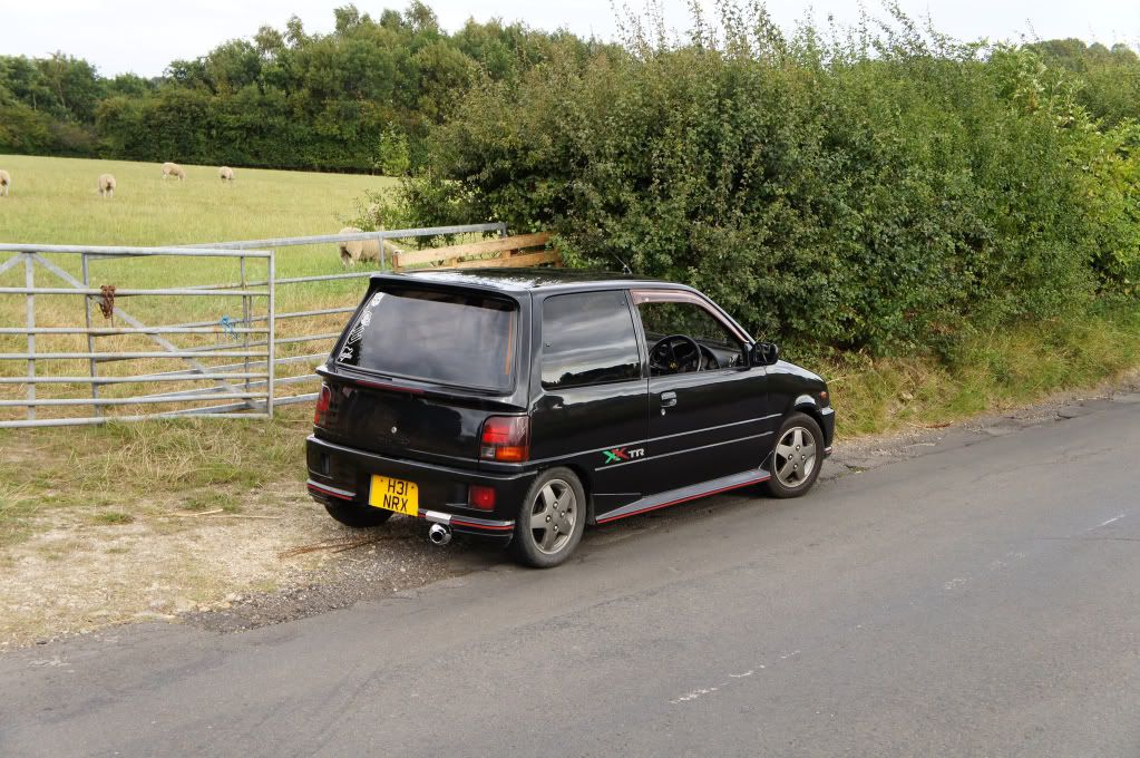

Here's my car....
Its a 1990 daihatsu Mira L200 with a 1998 EF-RL engine.
Here in the uk info on tuning these cars is very very VERY difficult to find! I have been to a drag strip as most of you guys do everyday! BUT I do use the car to drive to and from work every day.

when I increased the boost to 16psi I thought that the engine would require more fuel but I was still getting a very rich AFR of 10:1 @ WOT. I trimmed it down using the SAFC to 11:1. My first question for you guys is when does the engine require more fuel? I see all you guys use bigger injectors and fuel pressure regulators etc. But at what stage do I need these? I see my main issue is not been able to retard the ignition timing to prevent detanation.....
I will let you guys see what you think, I hope you can help.

Way to go man... had use this engine b4 in my Kancil... infact this engine injector cc is big coz I had used stock with evo III fuel pump boost at 1 bar using AFC NEO to adjust the fuel but really shock is adjust from 0.7 bar to 1 bar yet still rich and adjust until the last few k RPM at -14.

72mm low compression or 73mm low compression pistons are suitable..both can give more boost even can stand for 30psi..your current hybrid turbo with std head gasket can support till 23psi boost but at least you have bigger injectors and bigger fuel pump..it's necessary to change them to a bigger size..better you find low ohm injectors..since you have safc,it will be more easy to retune the fuel..and go get good fuel regulator also..
you can use toyota starlet 2e piston also.but need a lil bit modification on piston head. good piston for daihatsu mira. Malaysian keicar dragger also use this piston also.
