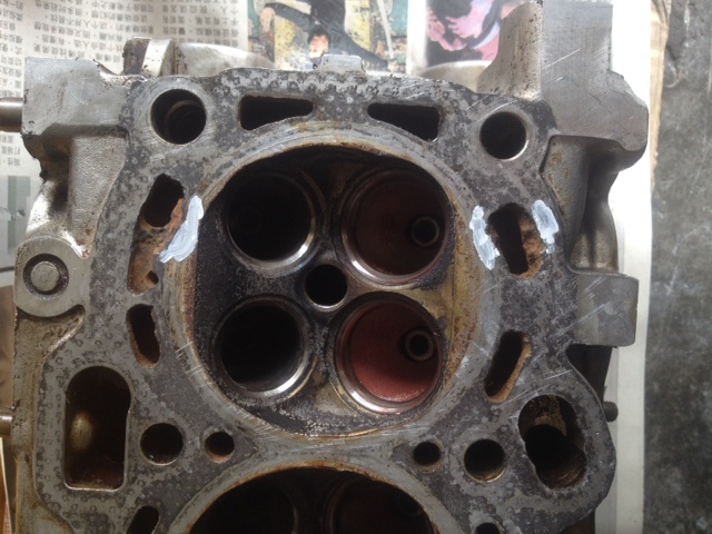

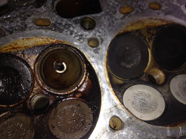

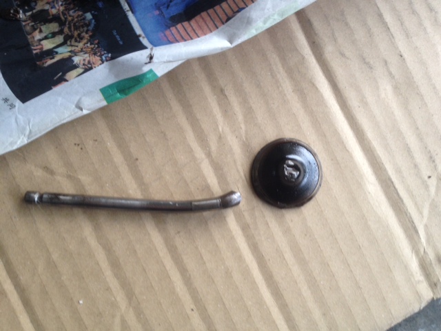

just swung by the workshop to check on my car earlier, ala this time is a bleeding one. my mechanic removed the cylinder head to check on the valves, found out:
1. one inlet valve is broken
2. one inlet valve guide is broken
3. cylinder head water vents (unsure bout term) has chipped off so need to weld and sand
also shown to me are my piston heads, one of it particularly has bad dents on it caused by the valves but i forgot to snap a pix.. more problems uncovered! :banghead:

your car were running lean... revving at redline a lot without any tuning done?
