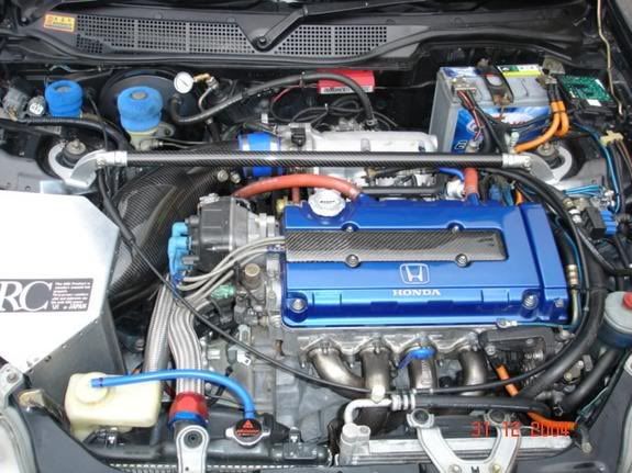

You can refer to HKS's method of CAI, since they did make one for the EK. Study their design and 'pirate' sket sket.
As for CAI's usefulness, yeah, I think they're useful, but I do wonder if anyone of you tested how cool is the intake from a CAI vs. a normal open pod without CAI.
So far, I'm getting about 42+ (cold weather) 47-50deg (at noons) celcius at the IAT sensor with openpod, but nor running CAI. As speeds build up, even a non CAI cooling seems to get cool air from the outside. I do realize my setup can be considered pretty hot, but that's because my headers are exposed, and not wrapped or coated.
Since it's a daily driver, and I don't really like cleaning the engine bay, I'm not a fan of CAI unless they're ducted and baffled to prevent insects, water, leaves, sand, etc. going into the engine bay.
but if the performance gains are worth it, I might go CAI as well.
