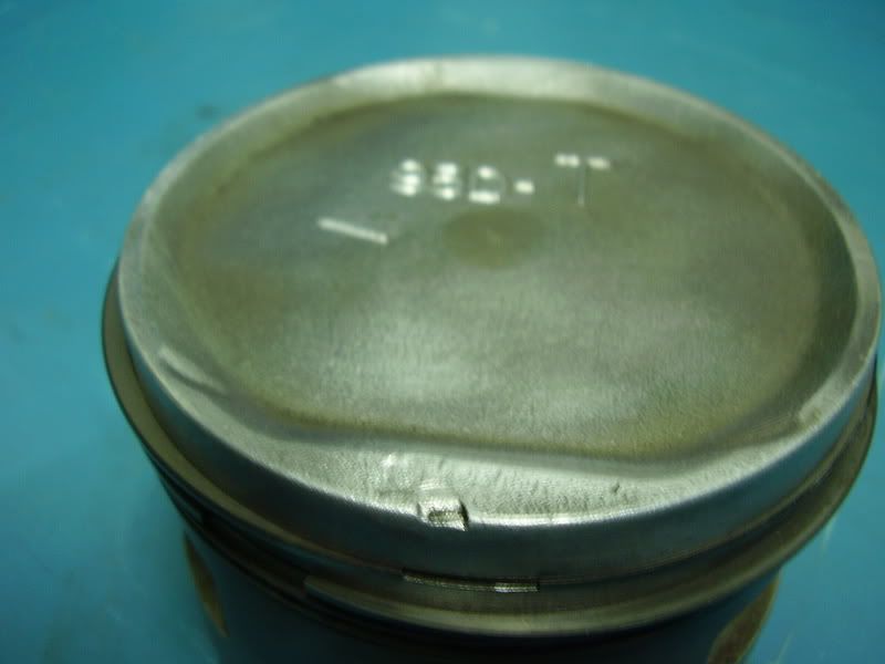

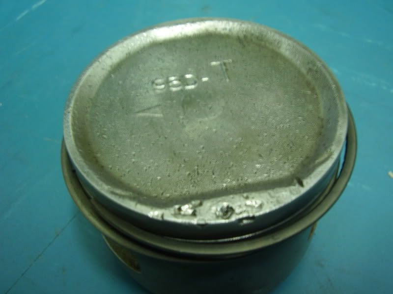

Hope ppl can give oppinion.The picture below is 2 pcs of gsr piston.The piston got minor corroded.Can it be use or not.Only this side is corroded.
FIRST PISTON:
SECOND PISTON:
Can the piston no.1 or no.2 be used? If no.1 cant be use,how about no.2.Hope sifus can help me...Want to use this piston for Bolt On Turbo project.
For me, I will not use it..
Just play safe and go to new part.. to avoid double job and $$
can as the side part look ok, wont leak engine oil to combustion chamber.
but do u really want that inside ur engine while boosting? even a perfectly healthy engine can break...
wat happened to the piston ?
how come so many little holes wan ?
oso the left side of the got severe damage
Only one piston like this.Are there any shop just sell one piston only?
Piston with pinholes are indications of lean conditions in that chamber. Try looking around, I'm sure chop shops will sell you one piece from a blown motor. You should also check that particular cylinder for tolerences. Cheers
buy new 1 lar bro.the sharp edges on the chip off part on the 2nd piston
can become glowing hot causing premature ignition.
tq for advice...I made really wrong decision coz buy this useless piston.Can ppl recommend me where can i get the new one?I need 1 pc only?
