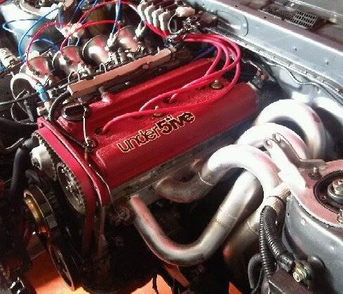

Edit: Prolly the meanest 20V in Malaysia:
Spec:
20v silvertop fully loaded complete engine:
kelford cam in/288 ex 288
kelford valve spring
1jz fuel injector
adjustable cam pully
head port and polish redo shim
trd o.8mm metal gasket
arias 81.5mm oversize forged piston
briancower steel conrod
acl race bearing
toda timing belt
ae111 fly wheel ,tinity clutch with trd pressure plate
silver top 4 throtle,alternator n starter all complete wit aluminium pulley
Now guess how much WHP this monster is pumping out..... hehehe

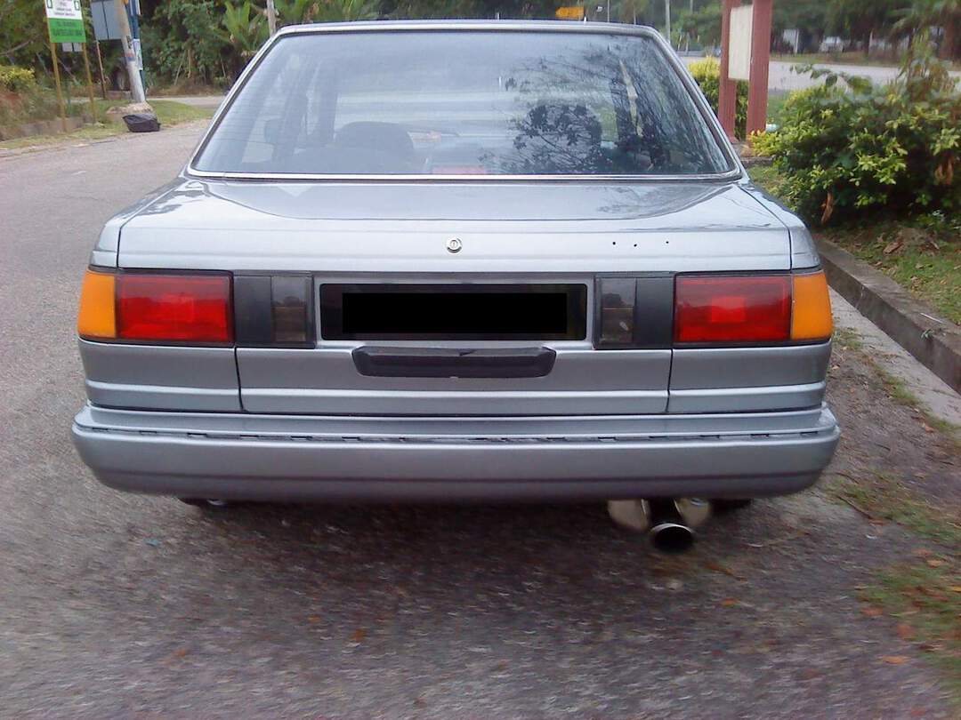

hi bro's & sifu's:adore:...
juz to share my ride:driver:...
*:bawling:still hav a problem to fix the suspention system:banghead:..now use ae111 spring/absober for front and ae80/82 spring/absober at rear...isn't posible if i plug n play ae111 spring/absober for rear suspention?...

hi bro's & sifu's...
juz to share my ride...
*still hav a problem to fix the suspention system..now use ae111 spring/absober for front and ae80/82 spring/absober at rear...isn't posible if i plug n play ae111 spring/absober for rear suspention?.../QUOTE]
Hi, kareze69.
If you're already using disc brakes on the rear, then you can use the AE111 absorbers & springs. I believe you're still using the original drum brakes on the rear coz you're now using the AE80/82 suspension, am I right ?
The AE80/82 knuckles won't fit the AE111 shox, bro. Holes not ngam. I think we've gone thru this topic many, many, many times before. Pls read thru the older posts.
TQ Sifu...how r u?...:beer:
i'm already converted to disc breake on rear...but my foremen make custom base bracket to fix the original st150 shox & Ae111 caliper...in ur opinion, which better if i mod back my rear shox to fully ae111 system OR i'm buy ae111 sport shox and custom the knuckle holes?:hmmmm:...others, my rim+tyre already 'terkeluar' from arch...look like muscle car...but when bumping or with 2 passenger, the tyre was touch the arch & erode:bawling:..

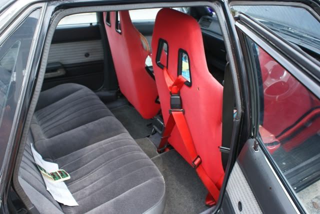

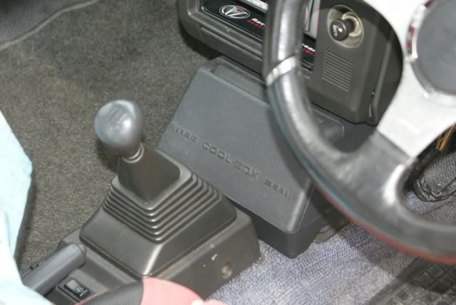

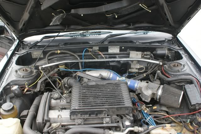

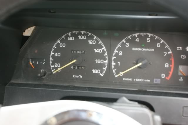

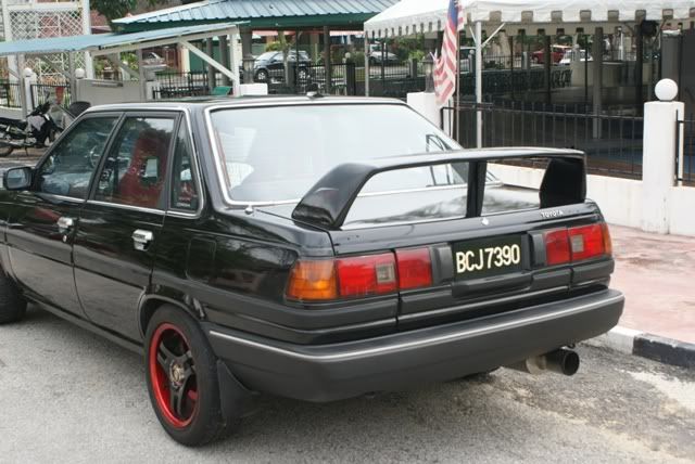

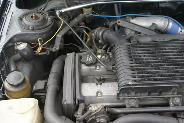

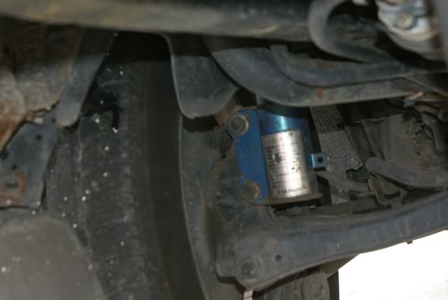

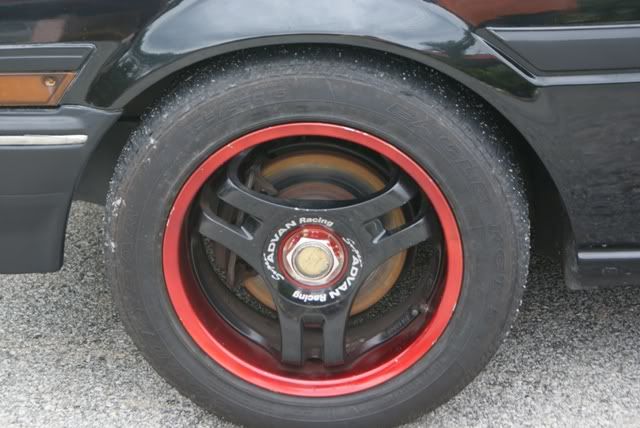

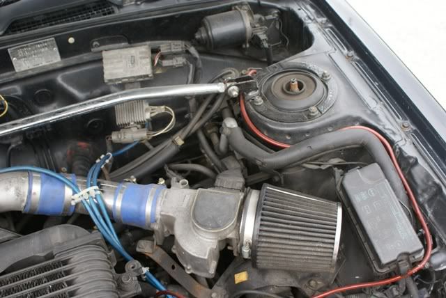

hmm really miss my corona..stolen at ss2 petaling jaya last 3 years..since this is a rare car and im quite suprised that corona thread now very active, perhaps anyone have seen this car (attached below) because ive been informed by friend of mine that they spot the said car at Ipoh area, please let me know..its hard to believe! hehe..its not wrong if i try right...
pictures for your attention:

Kareza69: hey man nice job on the car looks good... If ur around the subang/sunway area, gv me a call v go thanni! Teh tarik la...
Kareza69: Hi bro, nice ride there. On your problem, I'm not very clear on your current rear suspension setup apart from the fact that you're using AE80 absorbers and spring, but if your mechanic can help you to change the rear absorbers back to those from AE1X1, it would be better that way cuz AE1X1 absorbers are newer and easier to find, imho. What say you, sifu Yau?

Feezdya: Hehe, you've got to give kudos to Sifus 2o2r and Corona_ice for keeping the thread alive. Btw, that's one mean ride there. I'm sorry for your loss, bro. I always keep an eye out for any Corona's but I've never seen yours in the KL streets. Will let you know if I happen to spot it, bro.
