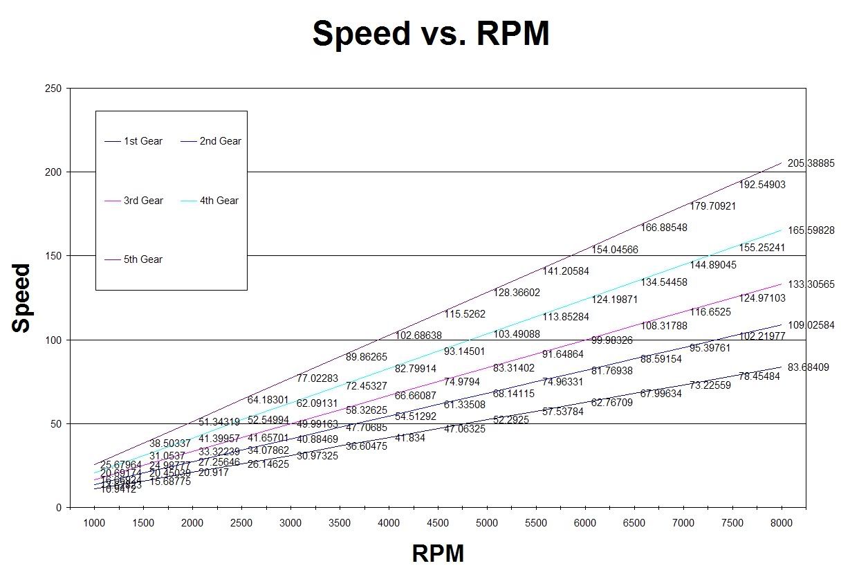

Anyway.. the owner wants to know if hiper racing can suggest some proper gear ratios for him.
The FD down to 4.266 already.. and running (forgot/55R16) (further reduce the FD.).. dunno what to do next.. the damn car still jumps like a frog on a hot pan on launch, and runs out of gears too fast... it can be considered that currently the car is traction and gearing limited.

Finally sorted out the gist of choosing the ratios today..
Already mapped it out on the computer for a visual idea of the gear stagger. Probably not gonna mess with it further.. just need to increase the RPM to a more extreme level. Extrapolation show that the gearing may just be competitive if we increase the rpm a bit more.
The body's much too heavy I think, still gets more wheelspin than movement.. Still, the final choice is up to the owner if he really want's to commit to doing up a seperate chassis for drag specific use, or stick with the streetcar weight.

hmm sounds like a nice idea.. but where to get the FD? currently using 4.267, not 4.266 as mentioned.. top speed at 230kmh so far, and it's a close ratio tranny.. so losing more time on gear changes than anything.

And here's the gearing map.. too tired yesterday.
As you can see.. change gear like mad at 8K.. I'm betting the driver lost more time shifting than anything else.. pickup can't be beat though, but still maybe stretching the RPM up to 9K will turn them into workable ratios, but need bigger injectors and a retune for that. With GE sleeves, and a 10K valvetrain.. I wonder how far the owner willing to go before grenading the engine... mind you, this car has only run on an isolated road for testing with no real competition so far.. owner still not willing to get screwed at the strip... yet. :P
And the speeds are a little off, but not by much.. it's unavoidable, esp. when you calculate the wheel circumference with a cropped 'pi' value which has 50+ milion decimal numbers. (I just plugged in the short version)
Probably will try to measure the exact wheel circumference for more accuracy tommorow.
