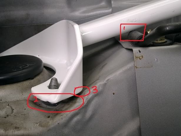

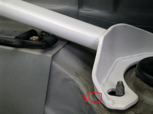

Hi guys, especially FGT who have been asking if the UR rear strut can fit in ae101. Answer is YES it can! However, still no bar for ae111.
refer the pics below
Notice the no.1 there the lock that holds the rear seat? It has to be cut of about 1 cm because the UR bar is resting on it, therefore u can see the gaps in no. 2 and 3 also.
After cutting the "lock", the UR bar rests nicely on the car body. Notice the no.3 gap is no more !
and this is the look after re-installing the seats.
PS : forgot to take pic of the modified lock pai seh :X
work done at EA Autoworks by howiechoo, also a forumer.
