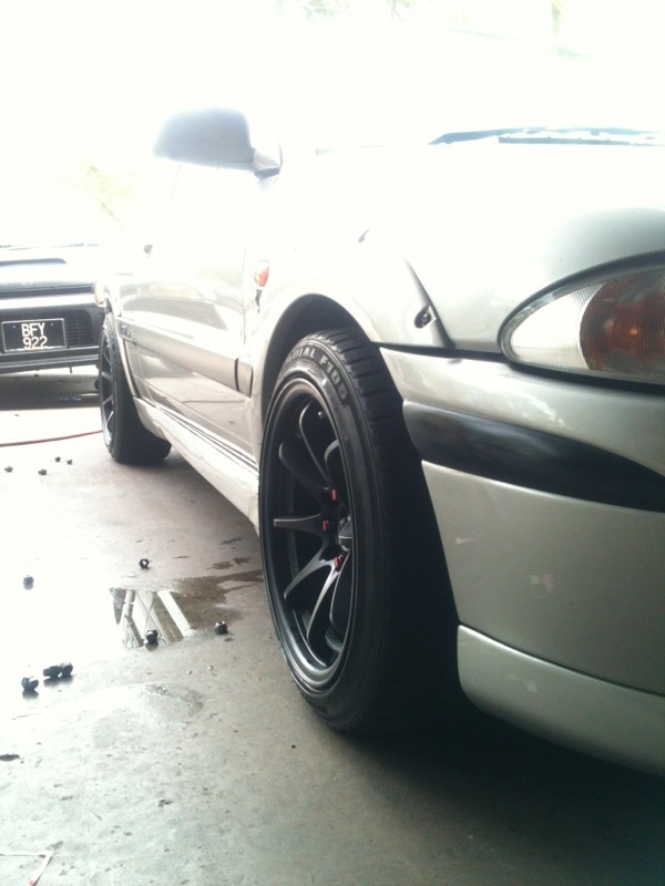

depends on rim design.....some may not clear your rear brake caliper (if yours was drum type then no worries)
but et20 rim definately u need to roll the fender a bit....
here is mine (15" rim et20) that even after i add 17mm spacer i still need to grind the edge of my rear caliper after replacing the brake pads (new pads was thick hence the slim space)

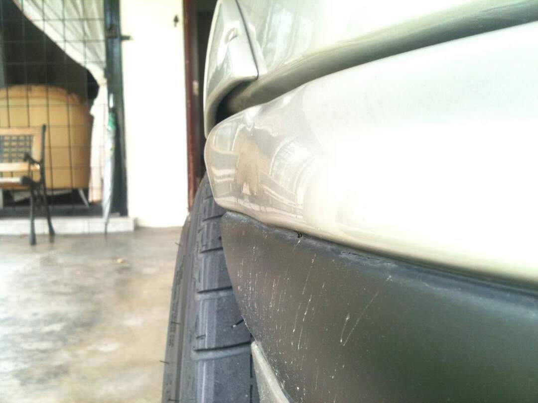

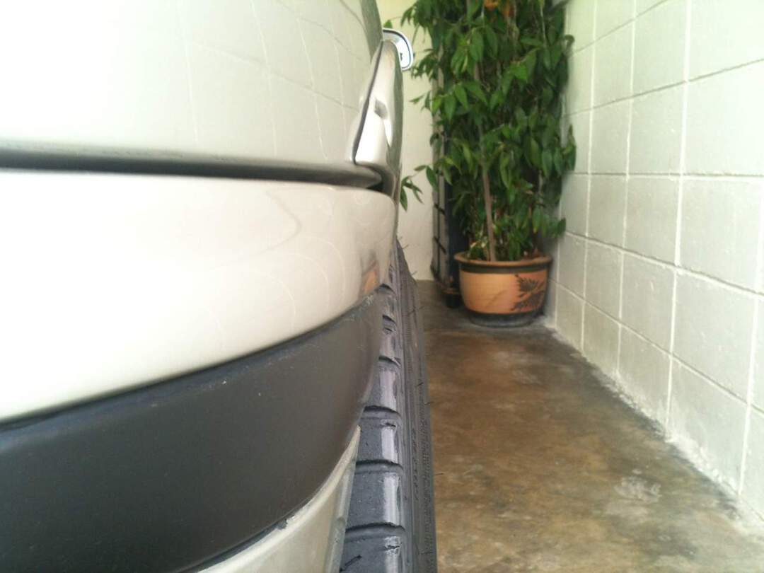

Updates: the front wheels cleared but not the rear..it was scraping the inside the sgti fender liner. It was scraping during corners and also on even road as well :(
Bro maze: I don't want to cut the fender lining arch. Sayang la bro..any other options your looking into?
This is how I look at it, I'm into tackling corners. After doing what ever it takes to get rid the wheel contacting the fenders, will I face more issues going into corners quick? If I have to sacrifice comfort and compromising hard corners, I'll change the rims back to non rota. 7j wheel with appropriate offset!

try set rear camber for -ve2.0degree :listen:

I reckoned try 1.5 first, the if clears... He doesnt have to do any shaving
