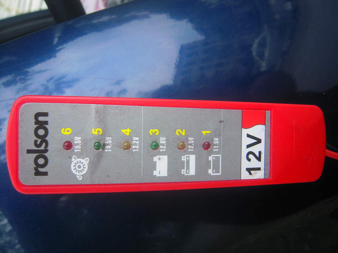

when exactly that the batt light usually turn on, is it @ idle, medium speed @ high speed, have u checked the alternator output power, bought 1 simple tester for batt/alternator power from ACE (darn the buyer for this diy shop is a good 1, maybe tonite i'll post the pic here) just bcoz got problem wit my batt before.:biggrin: what i'm thinking is yes u'r alternator is gonna give up soon, if it's a leakage problem than ur batt might be dead edi:hmmmm:

a fren of mine says, there is a place in pudu where they can mod the alternator to bigger amps using the original housing by recoiling the copper coil but i didn't ask where, btw got my tester pic.
