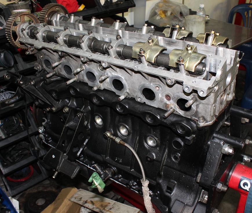

Currently we are building 1 RB3025 (RB30 block with RB25DET head). Still running in and we will do dyno tuning by end of this week or early of next week. Lets see whats the torque and HP we got from it. :)
Some pictures to share...

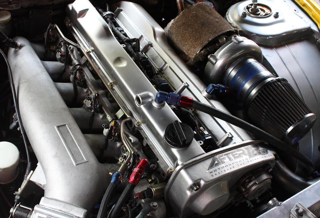

Looks awesome!!! What turbo is that?
Refreshed internals or forged? :adore::adore::adore:
